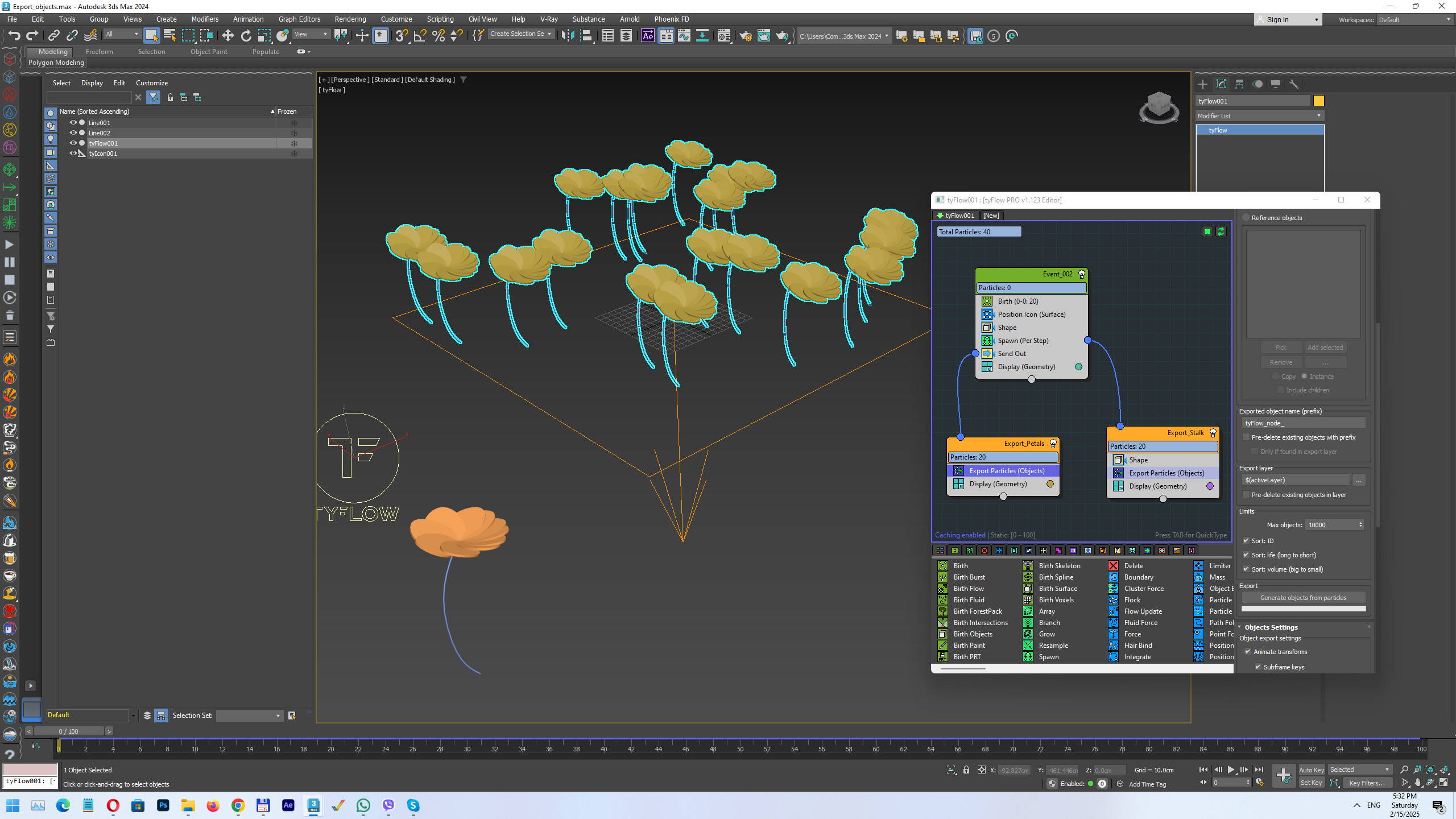

You can do it like this.
Make 2 objects from that flower object (stalk and petals).
Make sure their pivot points are at same place (bottom of stalk).
Then do the flow Like the one I attached.
Finally, click on export particles operators (both of them), and it will export you separate objects as petals, and separate objects for stalks.
There's probably even simpler method then this (maybe with using actors, or something... ) but this works too.. and is pretty simple.. so who cares? Smile
Attaching screen and max project.

(02-15-2025, 04:39 PM)d4rk3lf Wrote: You can do it like this.
Thank you very much!
