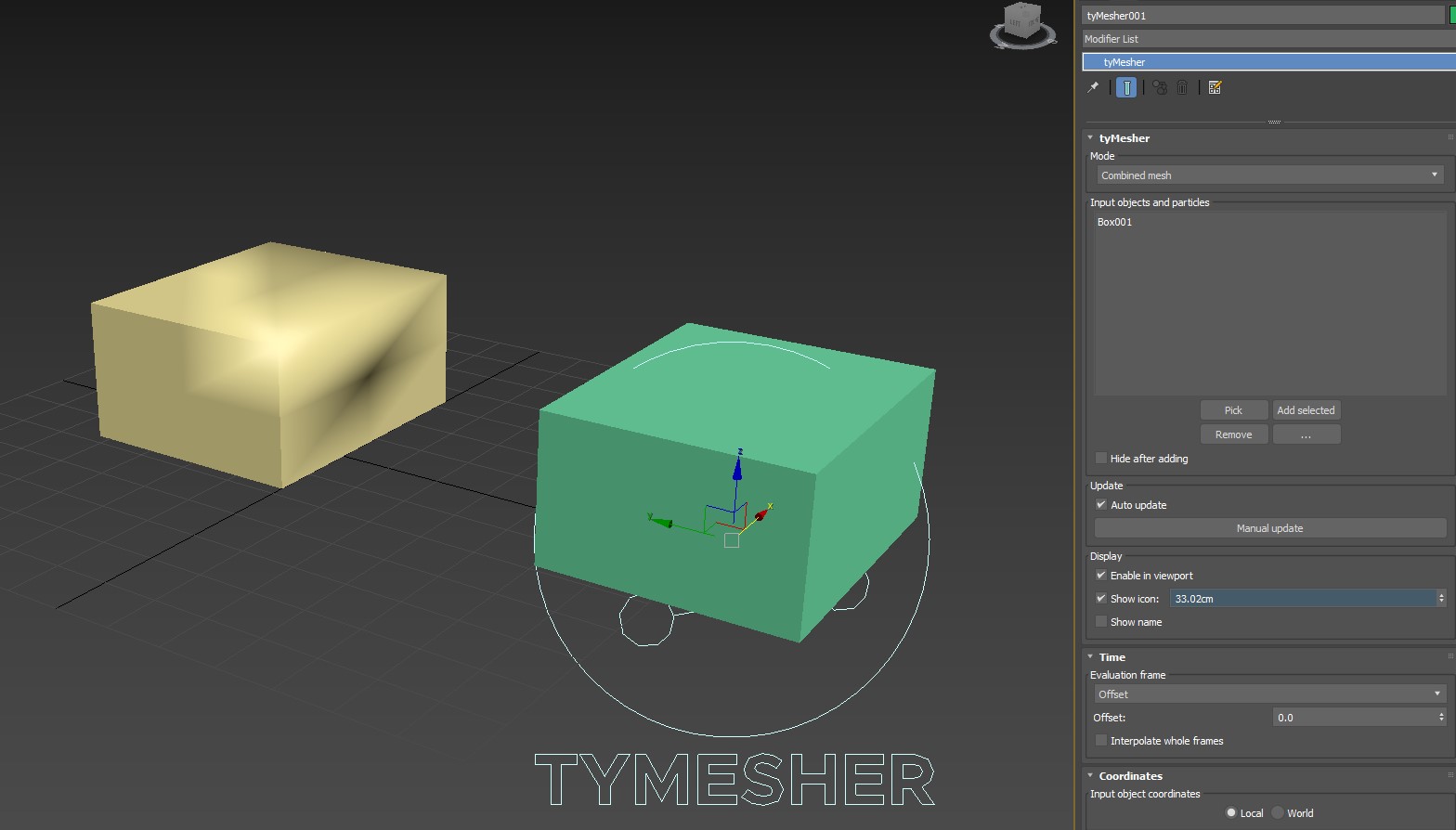

Hi Tyson,
As we use the tymesher object in a lot of situations (it became our favorite part of tyflow suite). We came across a problem - it doesn't transfer normals at all.
Here is a simple example with just a box with edited normals inputed into tymesher, and as you can see the normals are not sent along to the tymesher object:
Thank you for all the work
