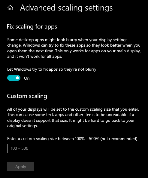

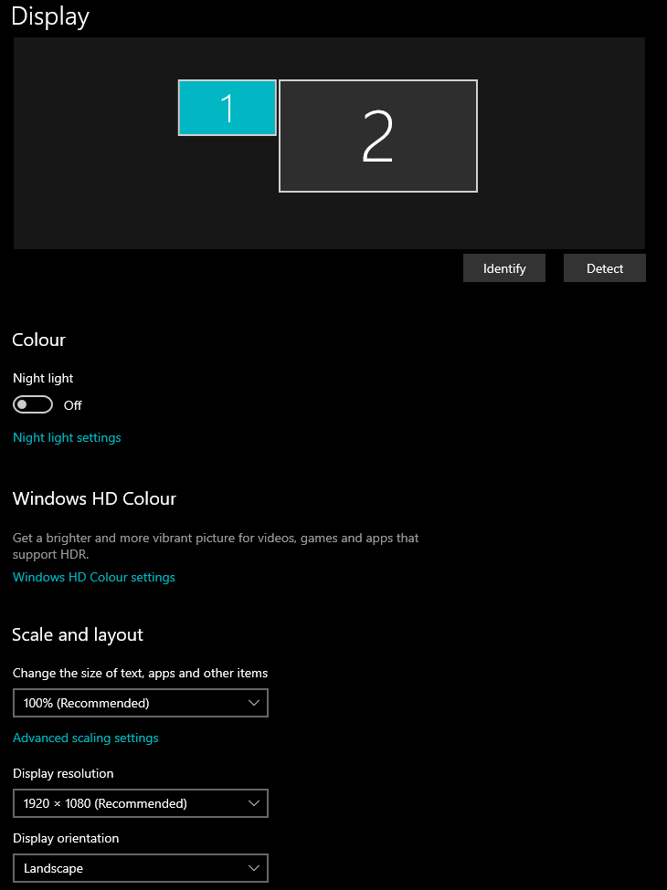

1) My screen resolution is 1920x1080 for the monitor I usually use Max on. I also have a 4K monitor, not sure if that would affect things or not.
2) I couldn't find windows scaling, I've attached some screenshots of the settings I have.
3) My system language is set to 'English (United Kingdom)'
