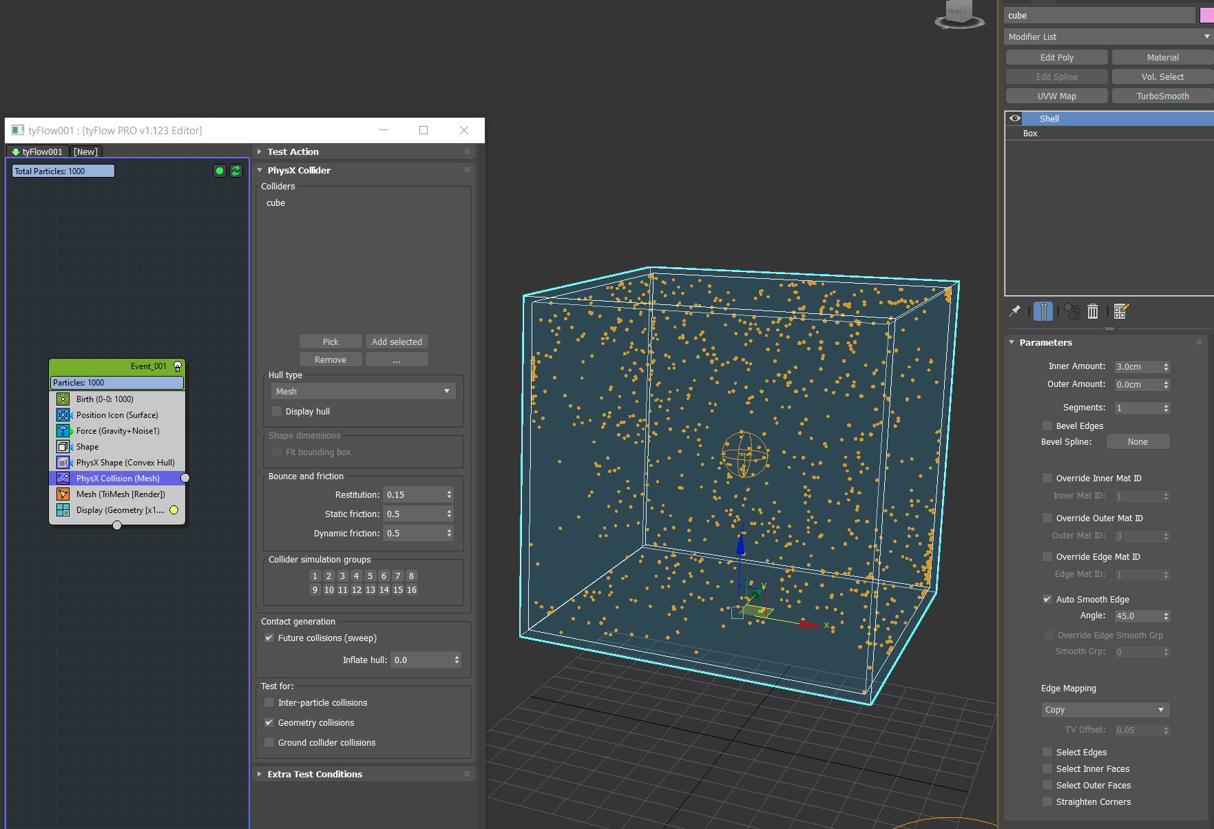

I tried creating a simple box as the volume,
I generate 1000 particles at frame 0 in the center of the box
and then add a noise force to make it randomly move.
I then add a find target in order for particles not to leave the volume.
It works but it's quite chaotic,
particles move inside but also around the volume,
I'd like it to move only inside it.
Any help?

Thanks for the answer but I see 2 problems :
- a lot of particles get stuck in the corner of the cube
- because of the Phys collision they bounce against the cubes faces like some crazy balls in a box
instead of flying inside the volume's limits (without touching them)

- Adding a +1 gravity to the force : I did that to compensate the -1 gravity that PhysX shape adds automaticaly (and...I couldnt find where to turn it off in the PhysX Shape parameters).
- spawning from a smaller cube's volume : you're right it does a better result in the first frames but after a few seconds the result is the same (particles bouncing against walls or ending up stuck in corners)
- No slow operator : I try adding one but it changed almost nothing, so I didnt keep it
I agree using PhysX is maybe not the best way to achieve the effect I want.
But it's the only way I found to contain the particles inside a volume (with PhysX collision).
But I'm definitly open to other solutions...
