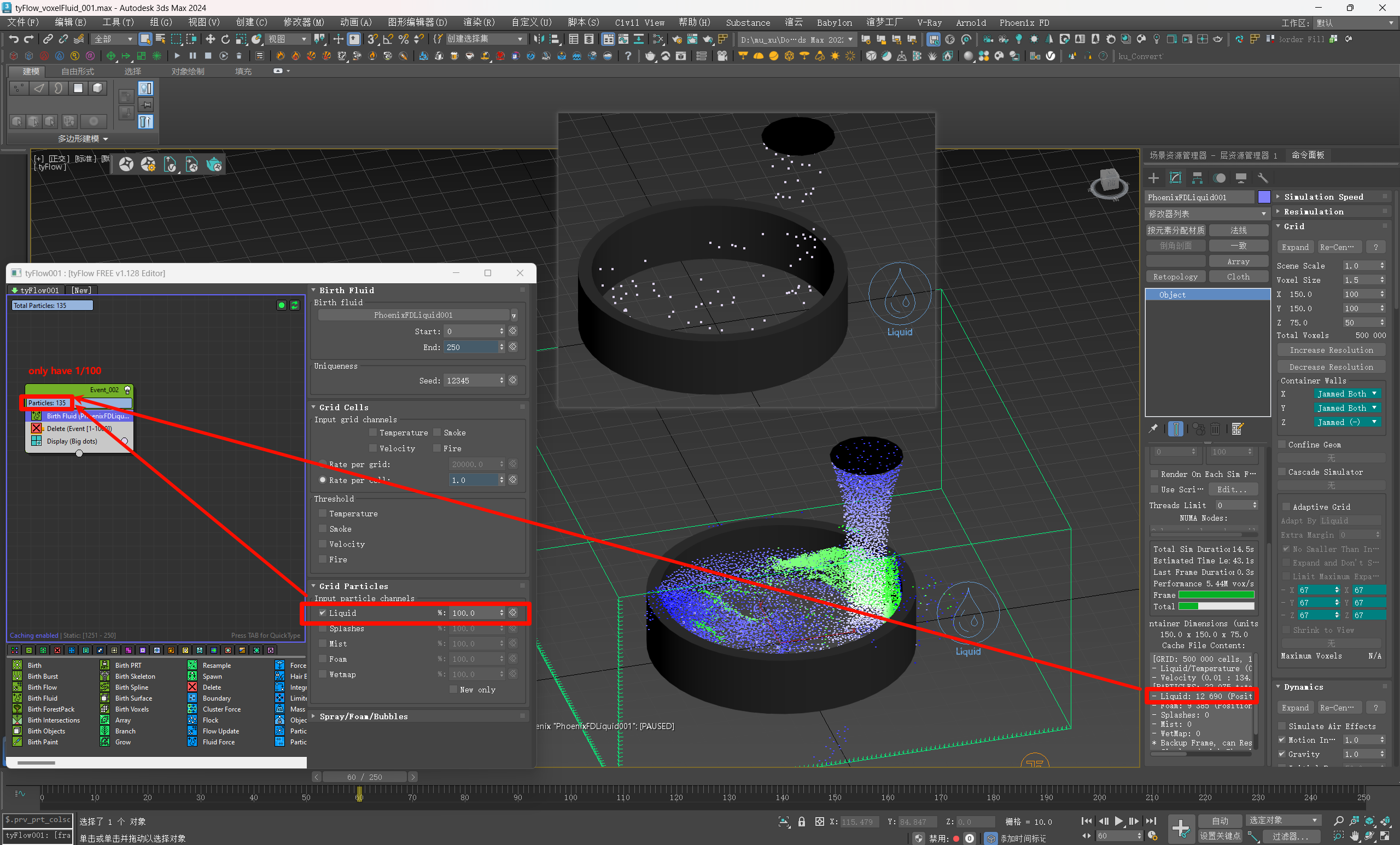

I used the "Birth Fluid" node. But the number of particles was very small anyway.

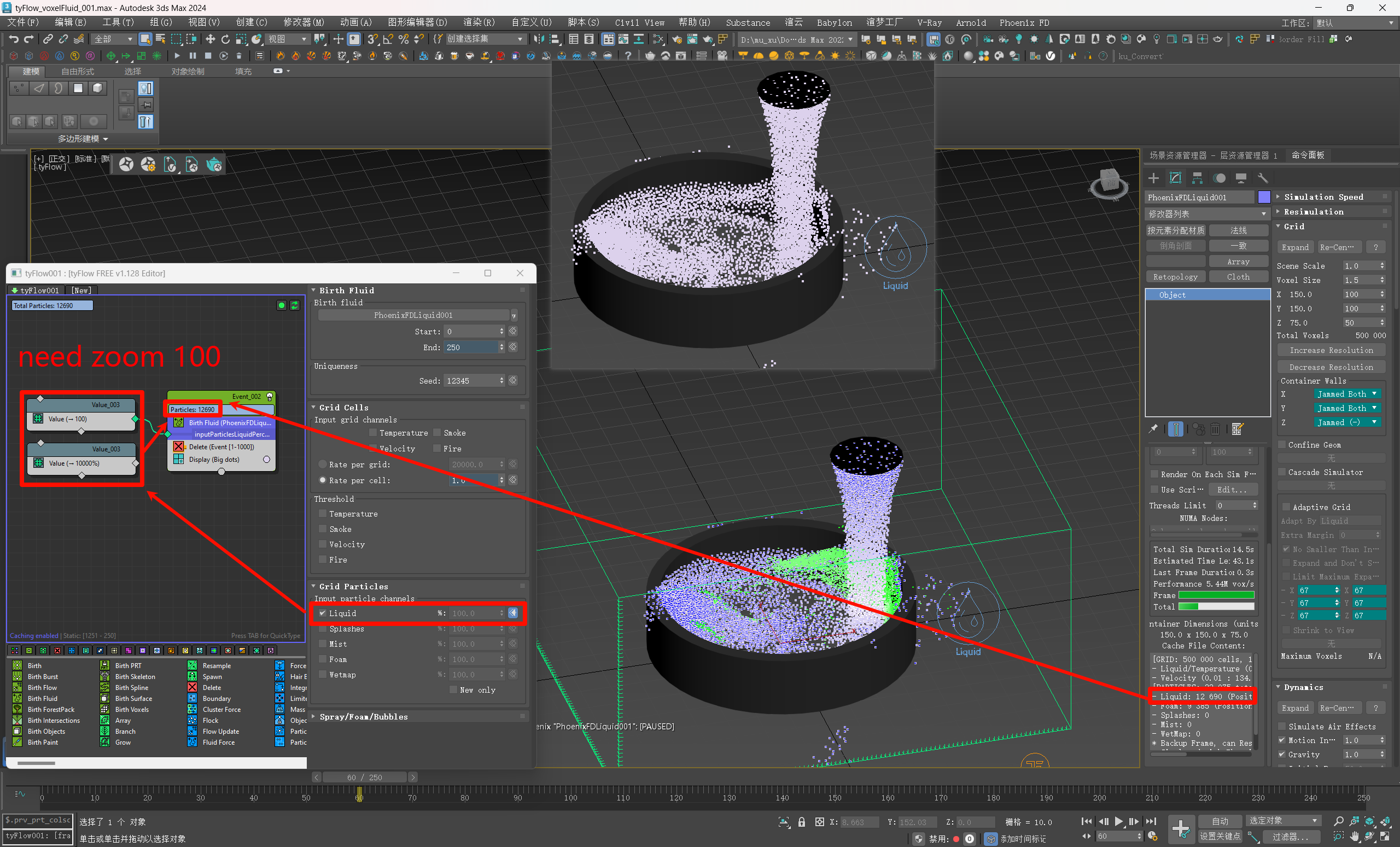

When I used the "Value" node to increase it by 100 times, everything worked fine.

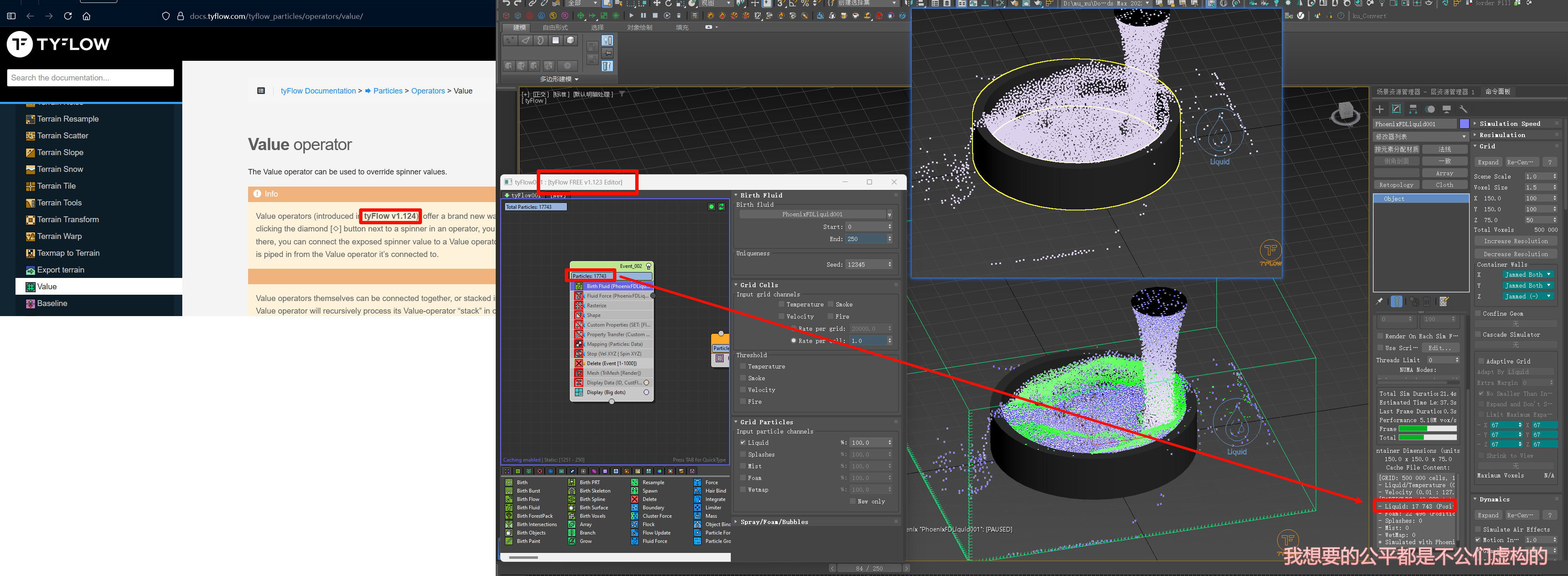

When I used the version v1.123 of the "Value" node that was not yet released, there was no such error
Thanks for letting me know - the issue will be fixed in the next build.
Please re-download v1.128 and the issue should be resolved.
(06-10-2025, 08:55 PM)tyFlow Wrote: Please re-download v1.128 and the issue should be resolved.
Yes, the latest version v1.128 solves this problem. Thanks
