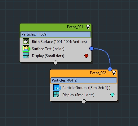

I'm trying to do an object reveal with a simple tyFlow setup. Birth particles on every vertex -> Reveal them with a sphere -> Show revealed particles -> Blob-mesh them with tyMesher.
I used a plane to debug my setup and found out that tyMesher behaves differently depending on the plane's geometry density. Rising the plane's density changing the tyMesher's "error pattern" (see example video). If it's lower than some particular amount - flow works correctly.
Is it bug or feature? Maybe I'm doing something wrong Huh
Thanks in advanse!
