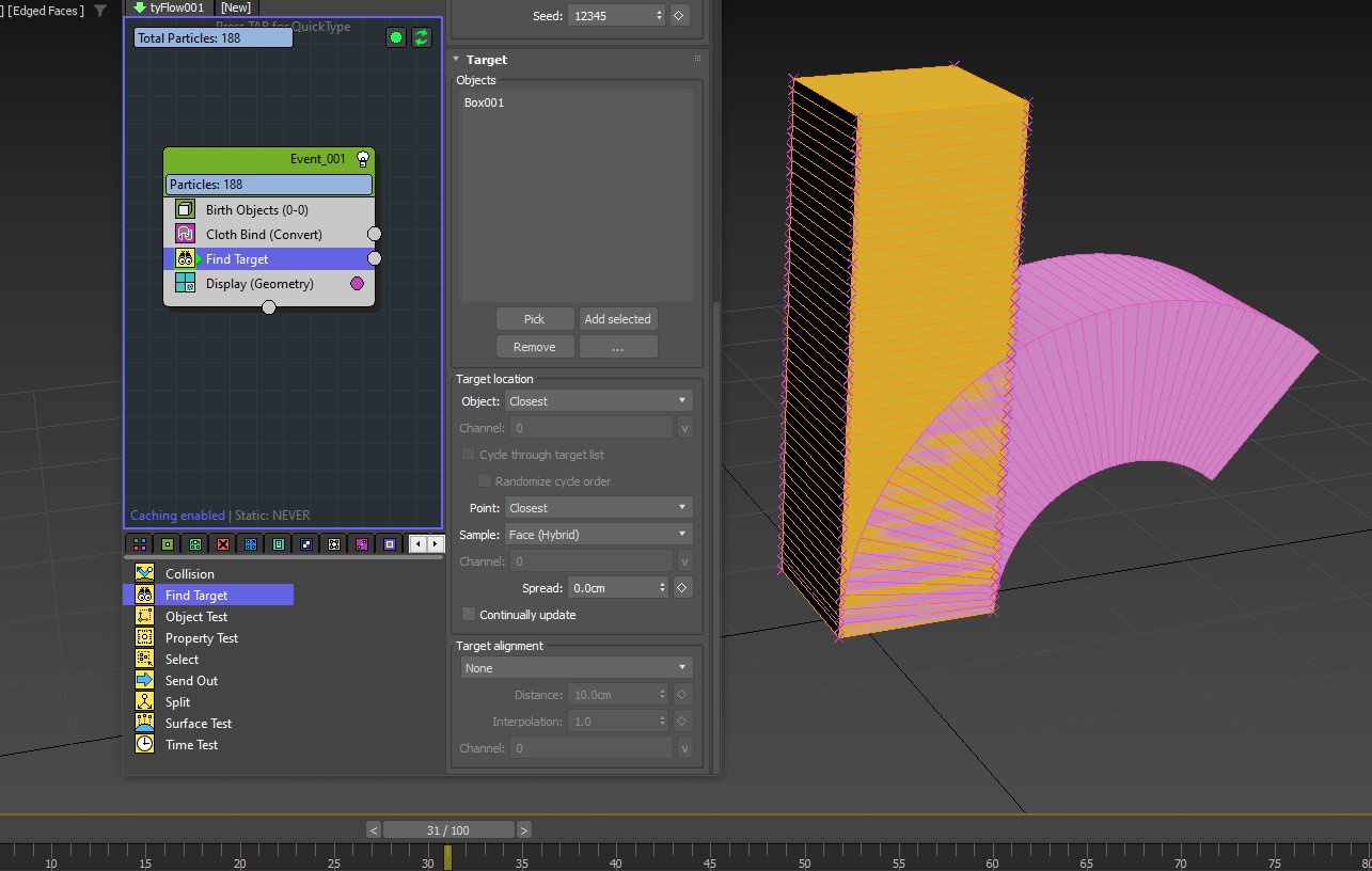

Finding Target_ continually update
'continually update' option in Finding Target operator seems to be broken
The continual update option works fine - the problem is likely related to you trying to use Find Target on cloth particles...they are likely resisting the forces applied with the Find Target operator, depending on your cloth settings. Either way, there's not much that can be distilled from just a screenshot.
