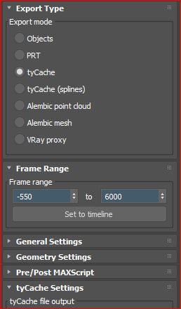

I have question about the tyCache concept. I'm caching a simulation and simultaneously rendering it in another session. The simulation in rendering looks a bit odd. I looked into cache directory and see, that tyMesh file has been updated latest in July. So should I need to wait this simulation to the very end until I see the cache rendering correctly? Instead of Gigabytes, the tyMesh file is 179 KB in size while the latest frame is 2 287 KB.
Compared to Phoenix in the same animation, I see it rendering correctly after each simulated frame (*.AUR -file).
With default settings you need to wait for the caching to finish for the mesh file to be generated. Or you can enable "backup at regular intervals" to have it generated every X minutes if you're exporting a particularly long sequence.
This clarifies a lot. However there's one question. Is it possible to process tyFlow cache simultaneously with rendering as long as caching process is ahead of rendering proces, or do I need to wait caching to finish first.
Now the caching is half way there, and the mesh file is already more than 13 GB. Max became very unstable and the rendering scene wont start any more. Is there anything I can do to reduce the size of the cache file? Or should I maybe try to create cacheless simulation?

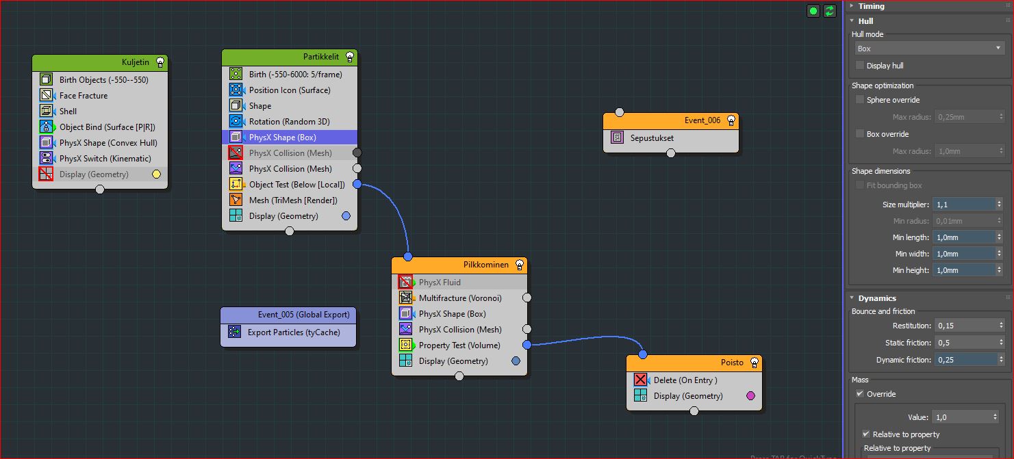

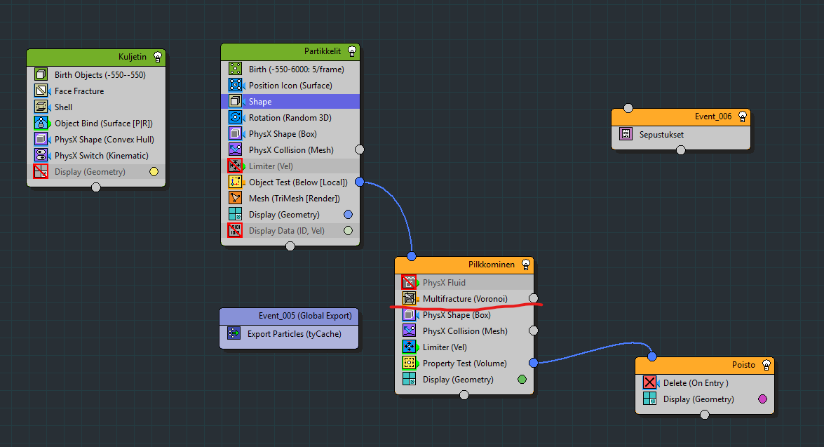

Returning to this. I wonder what is the best way for particle selection. I'm using Multifracture operator to disintegrate particles and property test to delete the particles when they are small enough. However not all particles disintegrate.
What would be the way to mark the particles that are supposed to bypass the Multifracture operator. I guess, I need to do this within shape operator, but how? Then of course I need to tell Multifracture which particles do not disintegrate.
Rather then "volume" in Property Test, try to set it as "surface area". instead of "volume".
Perhaps some of the particles are just several connected polygons without any volume.
Oh.. and it's a good practice to have particle counts displayed in the editor, so you can see how many particles you have in each event... just a little suggestion.
(right click on empty space on editor -> Display -> Display particle counts)
(08-21-2025, 01:25 PM)JuhaHo Wrote: What would be the way to mark the particles that are supposed to bypass the Multifracture operator. I guess, I need to do this within shape operator, but how? Then of course I need to tell Multifracture which particles do not disintegrate.
Didn't catch this question on the first read as important so I forgot about it.
So...
Same as you did with particles bellow multifracture (where you send them out and delete them).
Just place property test operator ABOVE multifracture operator, and mark them, and send them to new event, and all others that you did not mark, will be sent to multifracture.
Now, how you want to mark them (is the speed velocity, position, volume (or surface area)), is up to you, and you just set your property test operator to that.
Of course, as an alternative way... you can do that inside multifracture operator (in filters option), but if you unsure how to do this, the above solution might be more logical to you, and perhaps, more visually clear in a flow.

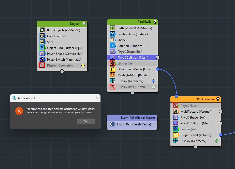

Is there a limit for tyCache size. I have noticed, once the tyMesh reaches size of 10 GB, Max crashes. The baking can take up to one week or more and after that, at the final stage writing ty tyMesh file, Max crashes if the file size exceeds 10 GB.
