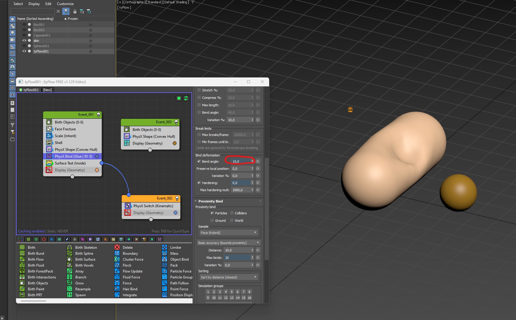

About bending object.
I saw this video.
He does not use a second PhysX Bind, but the PhysX switch op. he uses have changed (no sleep mode)
I tried recreating it, but no luck.
The object just bounces back from the bend.
https://www.youtube.com/watch?v=CneP1YT5ftg
Wait!
Sorry for spamming, Rob.
I figured it out.
The Bend angle was set to high.
The bend keeps shape without second PhysX Bind needed now.
.max   Dented Tank - Bend Angle 15.max (Size: 812 KB / Downloads: 213)
