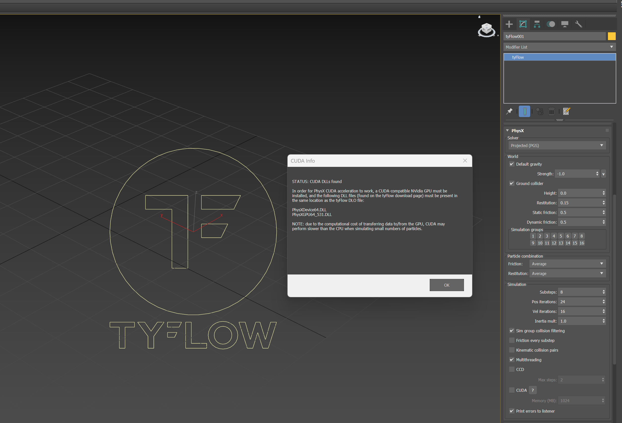

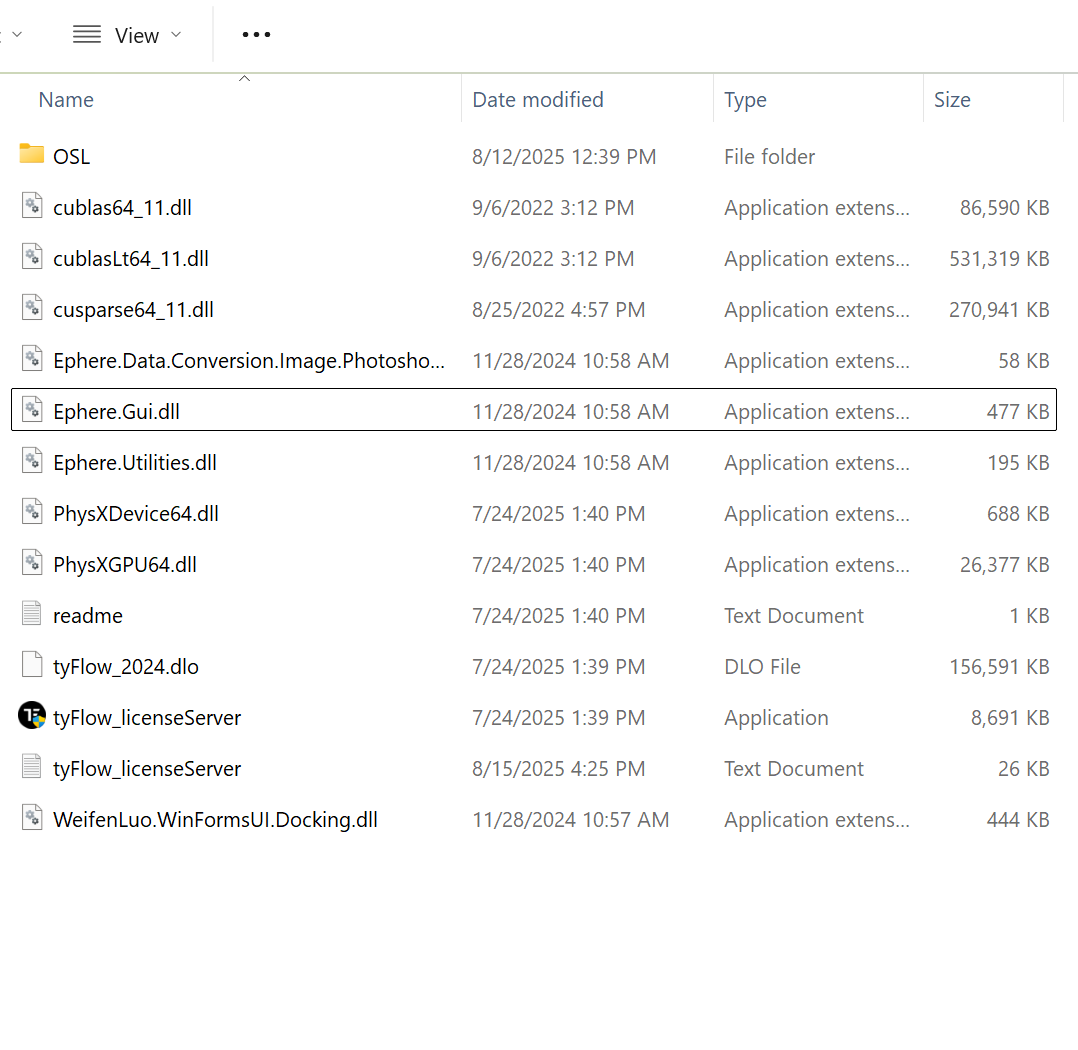

I am using and older version of tyflow pro and recently installed the Nvidia Cuda toolkit. Recent issue I am running into is that whenever I click the "?" next to the CUDA icon in TyFlow I get this error( images attached). I am using Tyflow Pro from 03-24-2025 as that was my last licensed serviceable version. I get this error both with the original CUDA Dll's from that release and with the newest CUDA files. Any idea what's up? Thanks in advance.
You need to download/install the PhysX GPUs for PhysX 5.3.1 available on the tyFlow download page: https://docs.tyflow.com/download/
Currently it seems like you're using the old pre-5.3.1 DLLs, with a newer (post 5.3.1) version of tyFlow.
