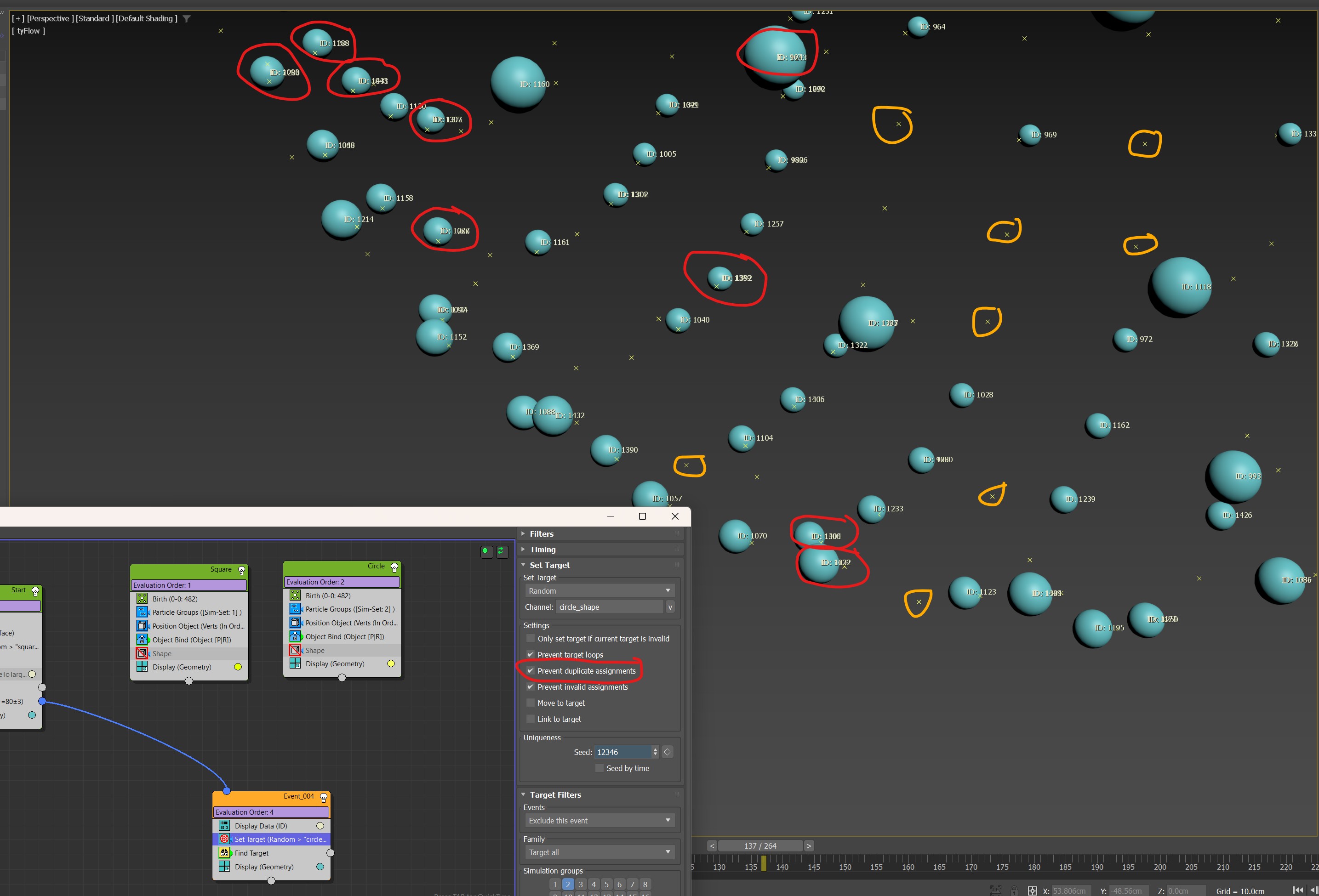

I'm trying to animate particles to all the vertexes on a set of meshes.
Each mesh has the same amount of vertexes (482).
I've made an event for each mesh and bound the particles to each, and applied a unique 'group' to each event.
I'm then using set target in a different event to move 482 particles to the first shape, then the second by using the 'target filters' of the two groups.
I've found that there seems to be a bug with the 'Prevent duplicate assignment' within 'set target' as you can see for this image, I get some particles targeting the same one and nothing on others.
Anyone know of a way to sort this issue, or is it a known bug?
