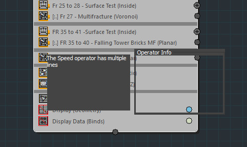

Not sure what makes this happen, it is kind of random, I managed to get this screen grab.  I am not sure this is enough info for you to do anything.   Max 2024 tyflow latest Pro 1.130
Screen grab attached

I think its a bug
I figured out when it happens, it only happens when you turn off the rollout display columns - ie: no columns - I do this when making tutorials and I can repeat the overlay by turning on / off no columns 'hide rollout columns.
At first its not there - you minimize and maximize the tyflow window and it shows up - then it keeps showing even if you close the tyflow window and re-open it - until you enable a column - then you can have problem free until next min / max of tyflow window - or it could be you have no columns set and you close and re-open the tyflow window, then it shows up. you get rid of it by selecting 1 column, then back to no columns.

Can you list the exact steps required to repeat this issue, starting from a fresh Max instance?
(02-06-2026, 10:16 PM)tyFlow Wrote: Can you list the exact steps required to repeat this issue, starting from a fresh Max instance?
I will try to get that info for you - I will try and replicate it step by step - get back to you
Rob
1/ Fresh TyFlow
2/ change layout to no rollouts
3/ close tyflow window using the x
4/ re-open tyflow window - now overlay is there
to remove
5/ right click / layout / 1 rollout
now its gone
I can go back and select no column at this point and the overlay doesnt show
close window with x again and it comes back
Rob
I added the steps, don't know if you saw
Rob
Thank you Robert - I am able to reproduce the issue now and I am working on the solution...
