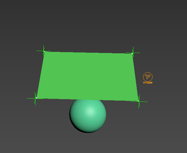

I'm trying to make the cloth tearing sample scene to work, but the pinned corners are not pinning, which results in my cloth to fall and not tear... I don't know if it's a bug, or something that I'm missing

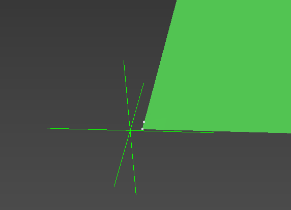

Could you post a screenshot of the first frame that you see when you load the file straight out of the example files zip? You should see the 4 corner particles marked in white since they should be sent to the pinning event based on distance tests to the 4 corner point helpers.
(04-01-2019, 04:34 PM)tyFlow Wrote: Could you post a screenshot of the first frame that you see when you load the file straight out of the example files zip? You should see the 4 corner particles marked in white since they should be sent to the pinning event based on distance tests to the 4 corner point helpers.
First one is when I open it, the second one is a closeup

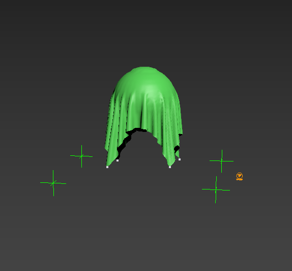

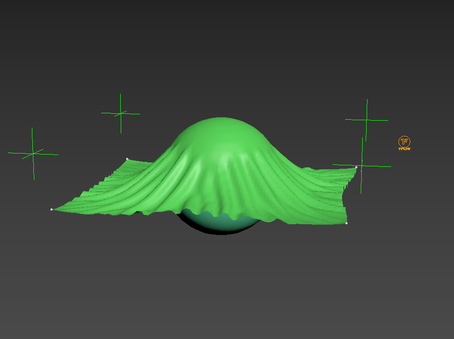

It works now, just had to open it again and it was fixed
Very odd that the pinned corners got pulled up in your first screenshot....if it happens again, let me know!
I tried. it was working here.
