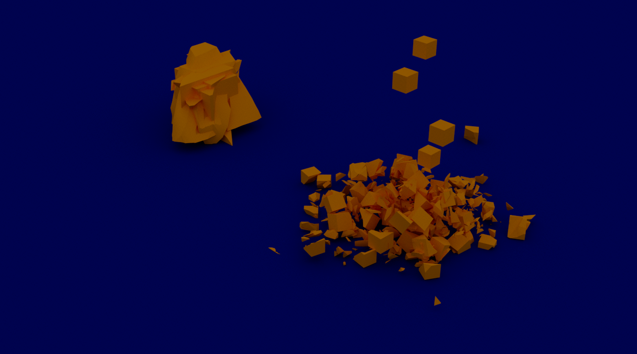

I recently had an issue with Multifracture. It doesn't render correctly with V-Ray.
So, I made a quick test with a simple box and the result is weird.
If you can have look on the images, you may have a solution for me.

I downloaded and checked with v.133, the issue is the same
I made another test with a "simple PhysX Flow" preset. Added Multifracture after a collision and it works good.
But the box I showed you, as a birth object, still do not make the job.
Here are the screenshots

Just realized my VRay NFR license is expired so I can't test the scene - but try putting a Repair operator after your Multifracture operator and enable transform reset.
It didn't work.
So, I exported particles and added an edit poly on top of the tyCache.
Looks weird, but it works good

This issue will be fixed in the next build.
