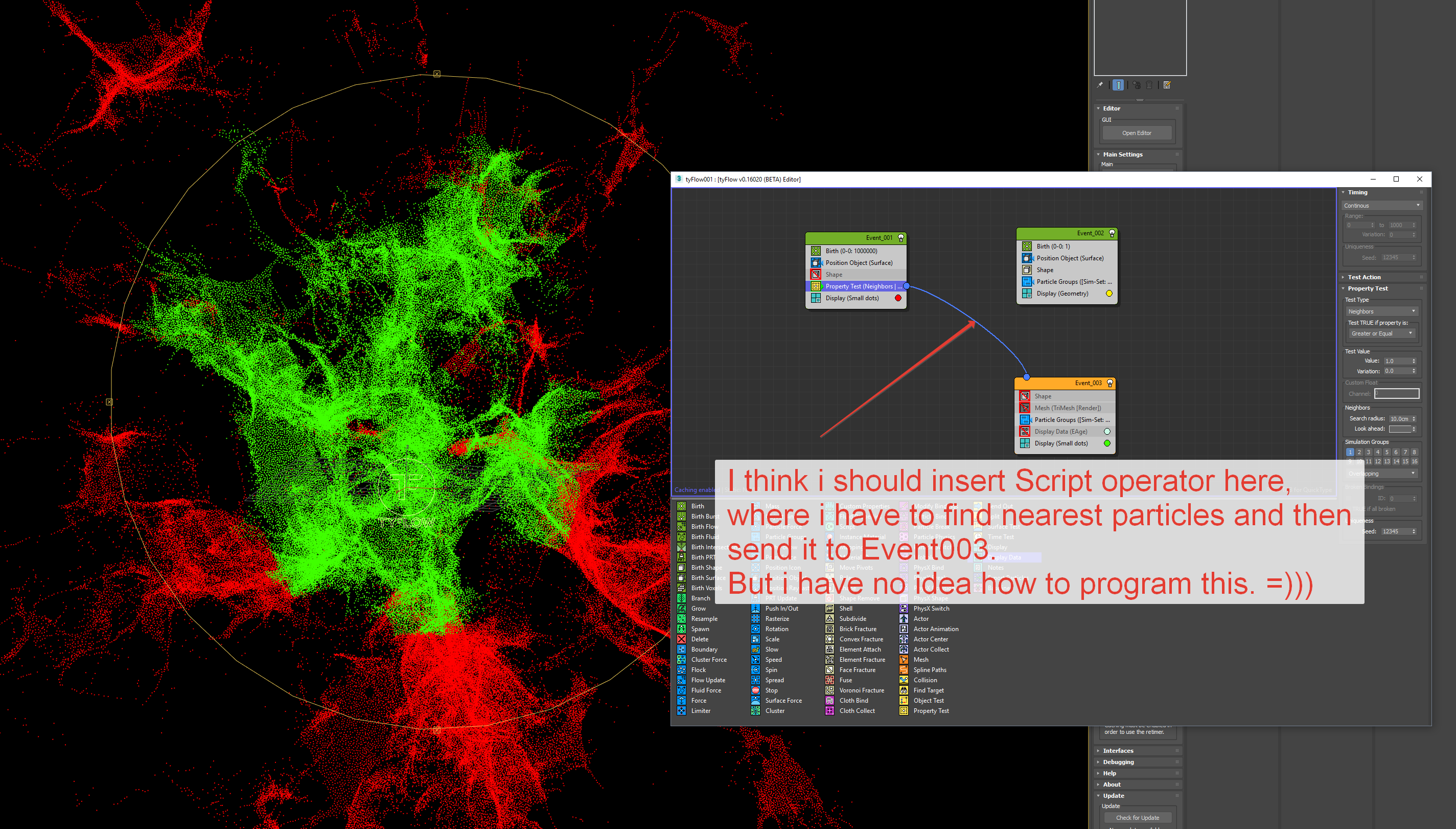

Hello, how to find a certain number of nearest neighbors ignoring the radius? Is it possible?
