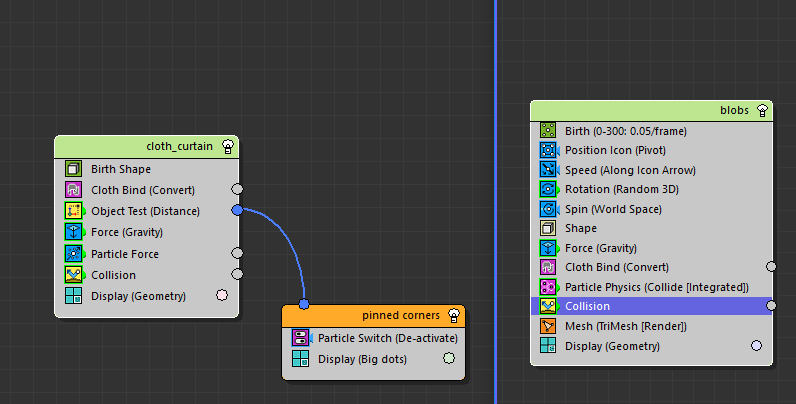

I've created two TyFlows; One for a cloth "curtain" and another for cloth objects.
I am shooting the cloth objects at the cloth sheet.
1. the cloth objects don't seem to collide with each other, they just pass through. I'd like to get the objects to collide together. My only idea at the moment is to create multiple particle groups and set them to collide somehow. Is this the correct direction to go or is there another/simpler way?
2. the cloth objects do interact with the cloth sheet, but the objects just continue through the sheet and the sheet reacts. I'm trying to get the sheet to affect the trajectories of the cloth objects. What can I do to make both cloth particles (sheet and object) affect each other?
3. the cloth sheet reacts to the cloth object before the object reaches the particles/geometry. Whats the cause of this?
4. the movement threshold of the cloth sheet seems to be very restricted to just the area where the objects passes through. Why does the movement not propagate throughout the rest of the sheet?
Thanks for you time!
