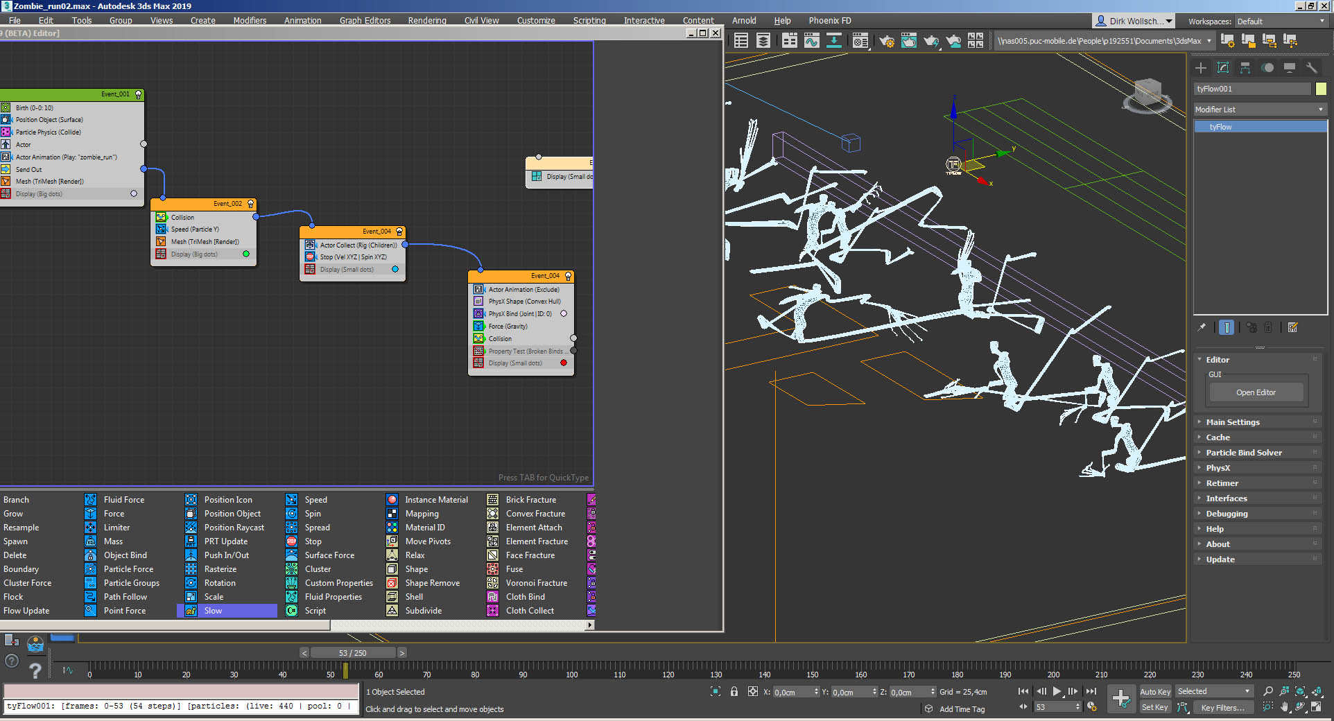

I don't get those bindings between the bones of my character to work. Scene is attached.
I want those zombies stumble an fall across the box.

The bind operator has no effect. Here you can see the problem/flow
Oh, I've looked at your file. It's not working because your bones have no geometry. They are just helper objects in the scene. So there is nothing to convert to PhysX, and thus nothing to bind.
(05-09-2019, 06:43 AM)tyFlow Wrote: Oh, I've looked at your file. It's not working because your bones have no geometry. They are just helper objects in the scene. So there is nothing to convert to PhysX, and thus nothing to bind.
Ah ok, I understand ;-)
What would be a possible workaround?

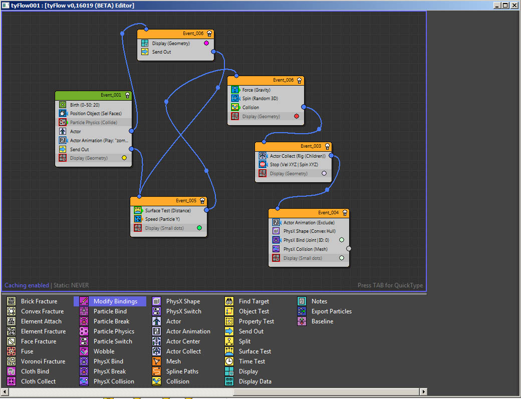

Ok, this worked so far. But some of the characters/particles are penetrating the collision objects and some directly fall through the floor.
Is there any possibility to avoid this?
