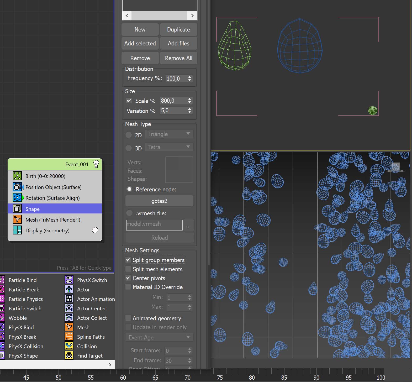

I'm trying different options to get correct results, but probably there's an issue with this.
"Split Group Member" option does not retain scale of objects when option is selected.
All meshes are with xform and collapsed.
In the attached images you can see the small drop gets bigger when "Split.." it's applied
Hmm....it seems like it's working as intended, no? In the second image, it's splitting up your group and thus the small yellow object in the bottom right corner of your group is being scattered as a particle (hence the new tiny particles).

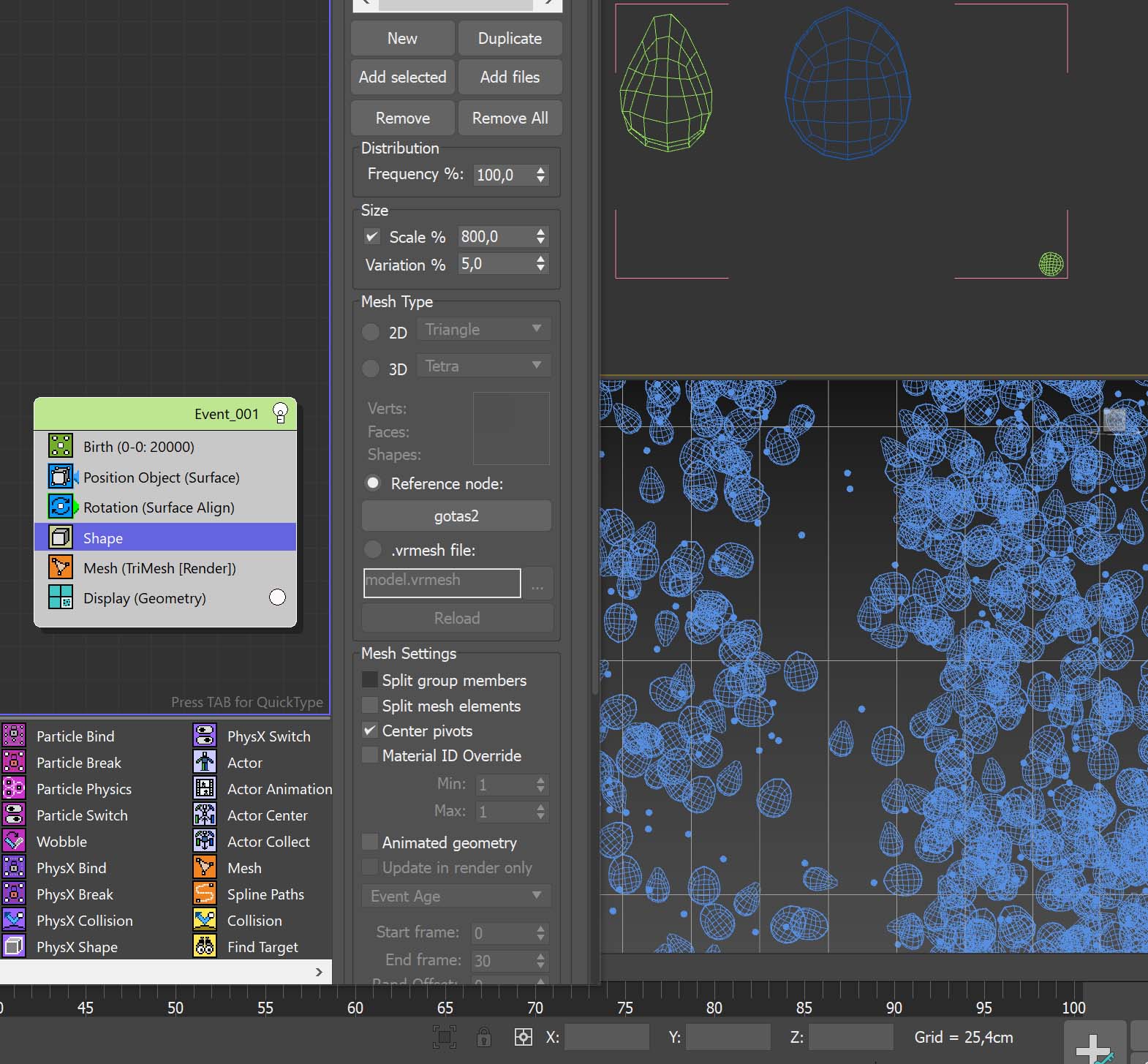

The second image is with the group (and no splitting) and retains the scale as shown in upper right....that one works OK because that's how the group is..
But with the option of splitting the group (first image), the smallest drop get "bigger" ....The particle that is just about in the center all alone i'ts supposed to be much much smaller, just like the it was on the group..
second image is A.jpg btw ..maybe that is confusing, sorry..

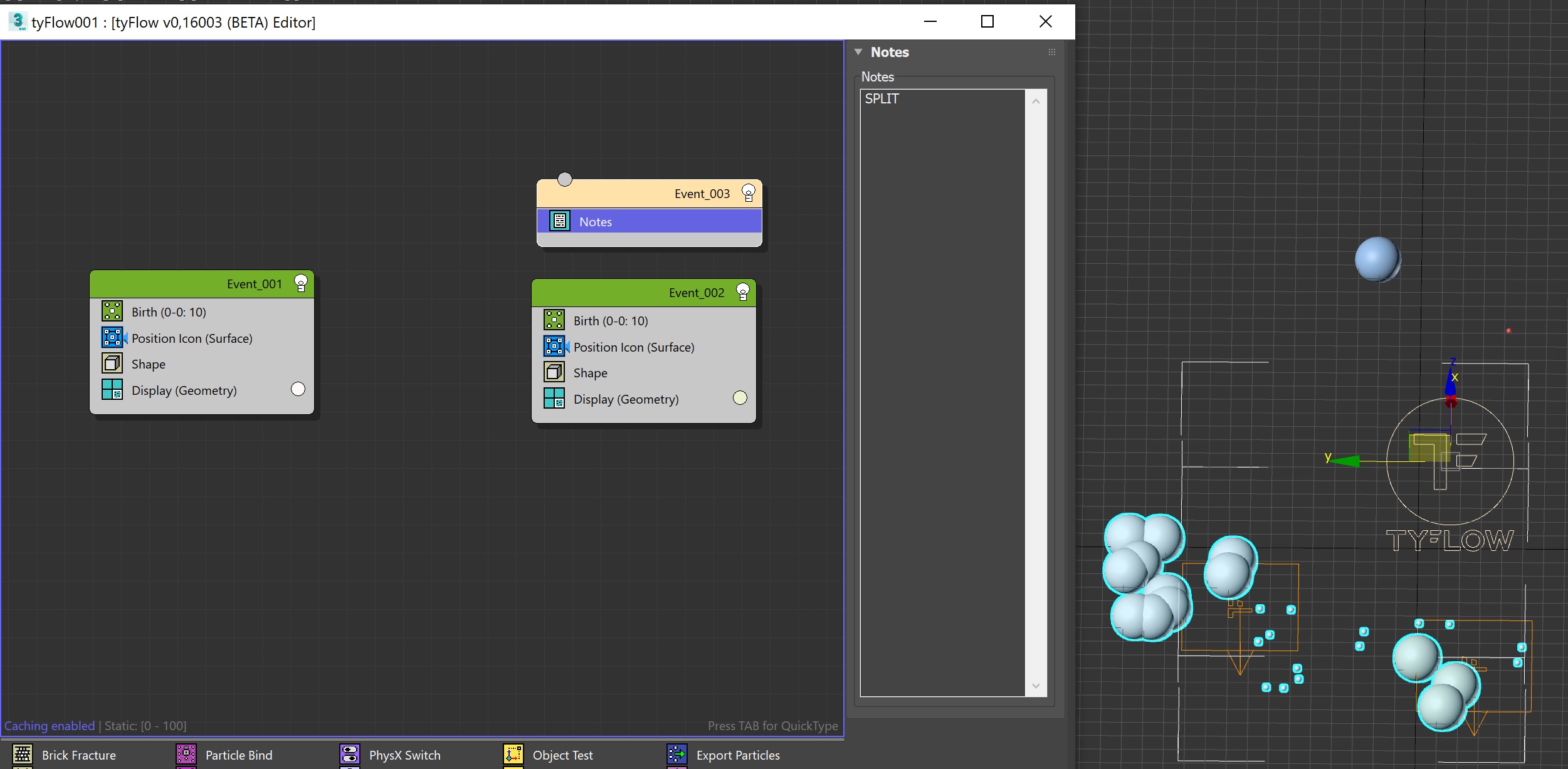

I've tried with just geospheres. But its not working with the drops meshes and they are just polys, "xformed" and collapsed ... :c
Hmmm...could you send the scene file to [email protected]? Then I can take a closer look at what's going on....
