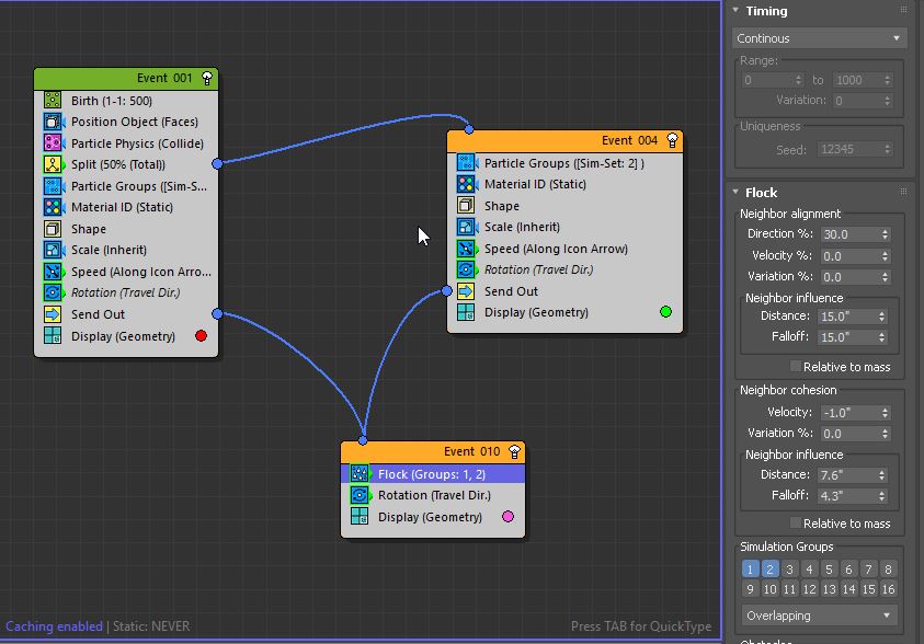

in this test some of my particles seem to be turning for no reason, others are not avoiding each other and still others are accelerating too rapidly.
I've included a screen capture of my flow plus what the flock operator is set to.
This is a crowd test for people walking opposite ways down a hallway or sidewalk.
