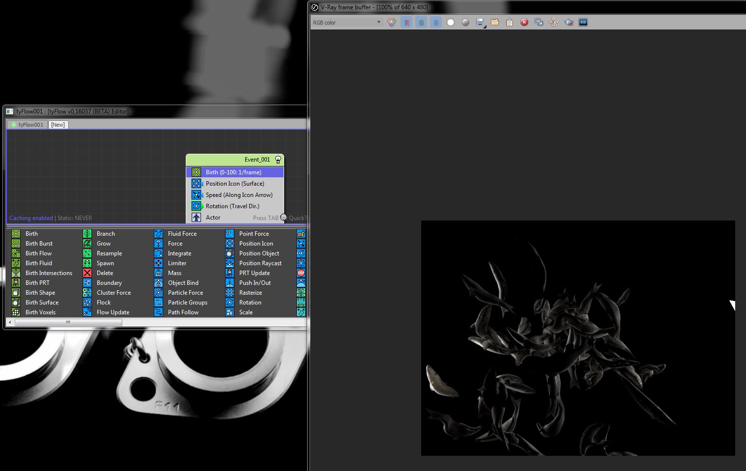

During the production of a VFX for our client I've this problem to calculate the VRay Velocity pass of a tyEVENT where Fishes (as rigged Actors) flyes out of water.

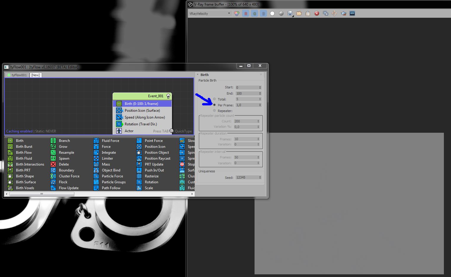

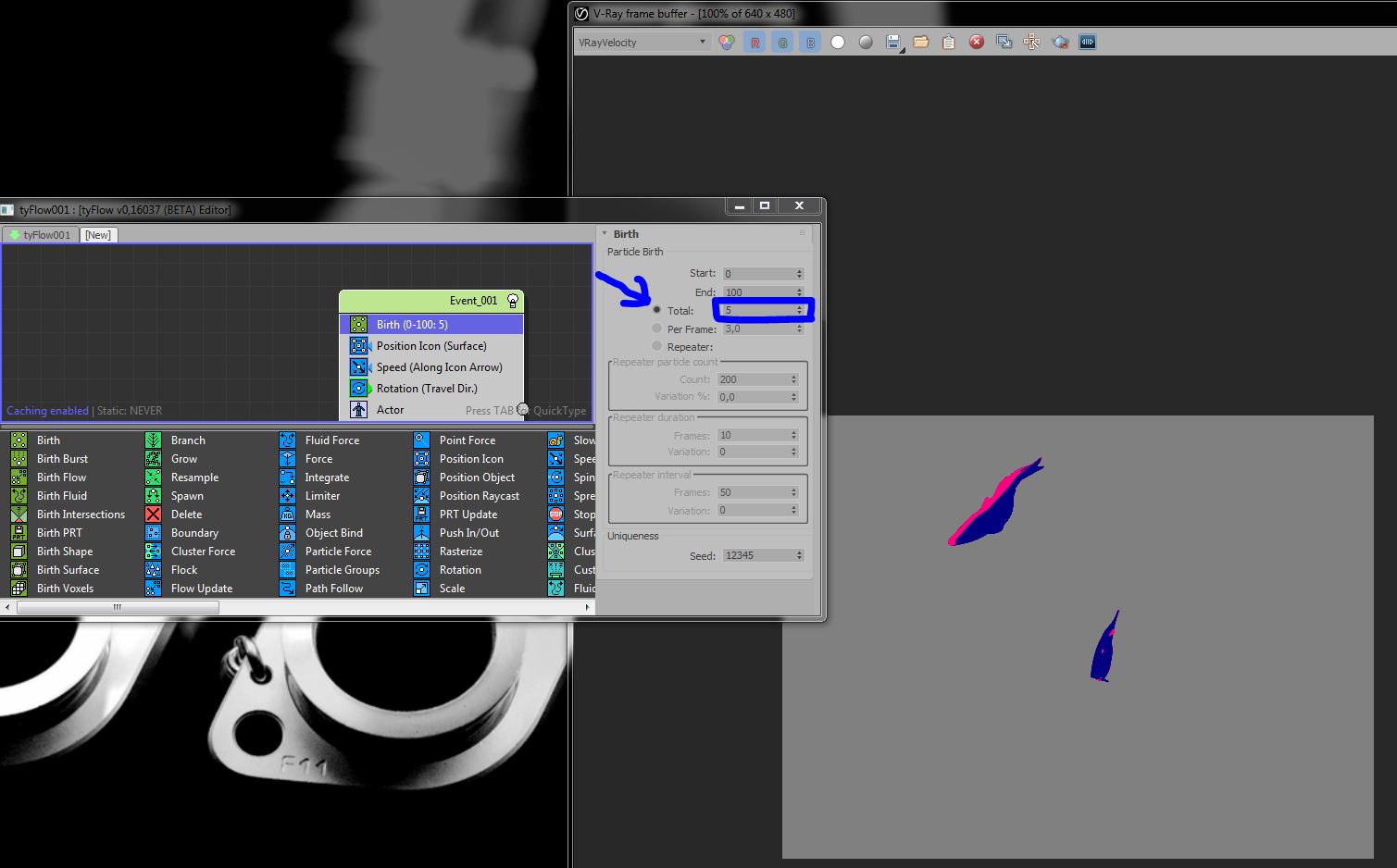

The Velocity pass in some random frames was calculate and in others NOT. I think that the problem is in the Birth node because with a simple scene the Velocity pass works but when I animate the Birth per pixel value, or if I raise the value of the particle in the total frame mode Birth, the Velocity makes this strange behaviour. I attached some images to let you understand the situation.
You can verify the problem even in your scene tyFlow_worms_001 (attached), if you change the Particle birth Total to a smaller value (i.e.: 6) Vray Velocity it's OK, If you left the value 100, the vray velocity do not appear, this behaviour happened with Vray GPU Next Update 1.2.
