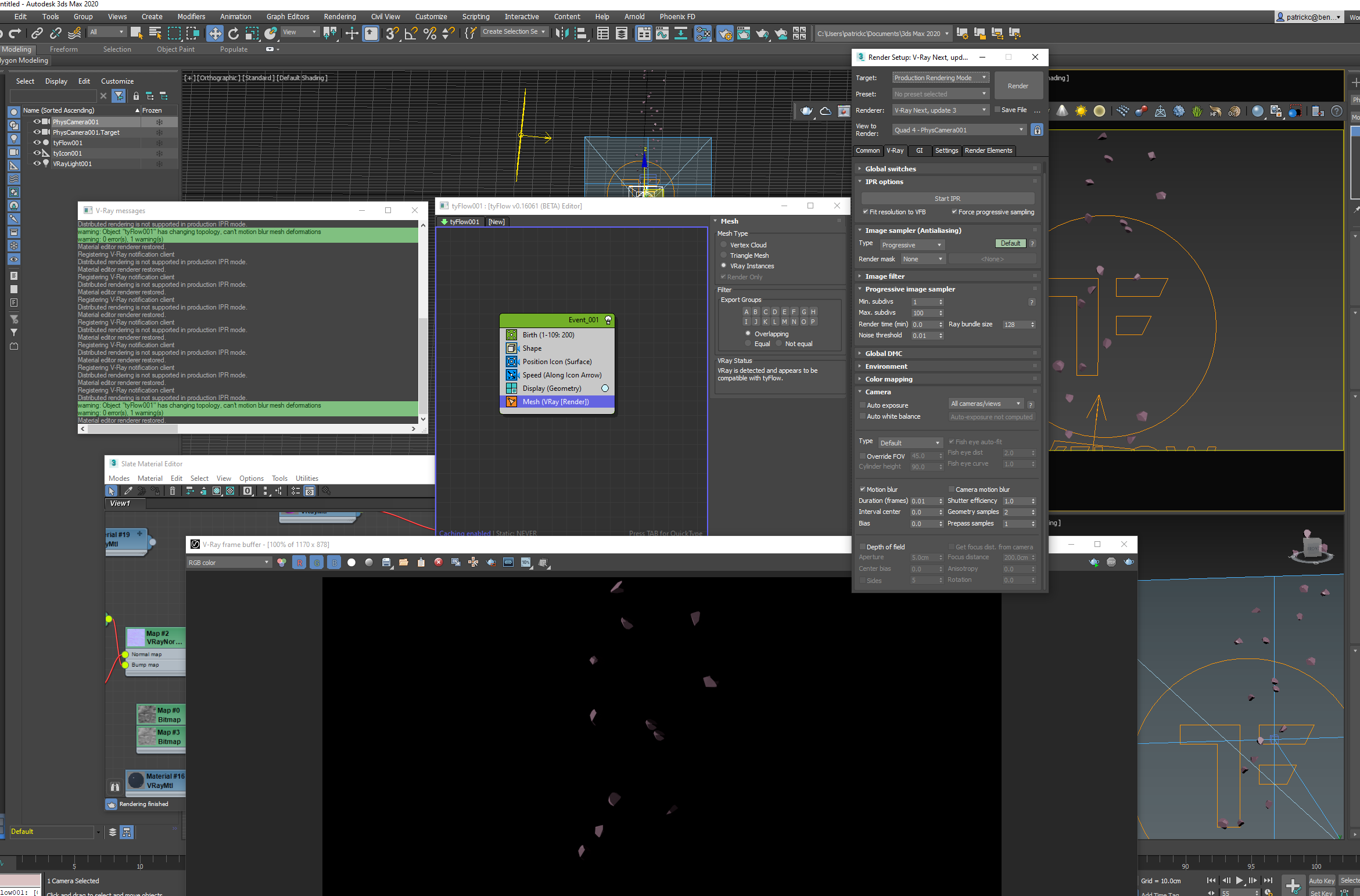

V-Ray Next Update 2: As soon as I click start IPR it crashes Max (2018)
System: i7 6850k@ 4.3GHz, RAMx64GB, Win10
Will find some time and record it.

Motion Blur in Vray only sometimes work. TF 0,16007 3dsmax 2019, Vray 4.2.
I had a scene with PhysX yesterday which rendered with motion blur. My actual scene with simple particle physics don't.
I've lowered the time step to 1/8 and checked Spin and Velocity in Cache but nothing helps.

vklein: tyFlow only supports VRay NEXT in 2020 right now. If you have a changing particle count in 2017/2018/2019, you won't get proper motion blur since your particles are being rendered as meshes (not instances) and thus it's having trouble calculating moBlur for a changing topology.

When I render (with the tyFlow 0.16010) a "single frame", the Motion blur works, when I render with "active time segment" it doesn't work...

Vray material displacement doesn´t seem to work, if you assign Material to tyFlow icon.
Vraydisplacement modifier works, if you set mesh op to triangle mesh and untick "render only".
Vraymaterial displacement would be handy in case you are birthing different particle shapes, that are supposed to have different displacements on them.
Very odd Steve...I'll make a note and look into it when I can.
insertmesh: I'll look into the VRay material displacement problem too. Although a displacement modifier will 100% not work when rendering as instances, since instances aren't modifiable geo.
