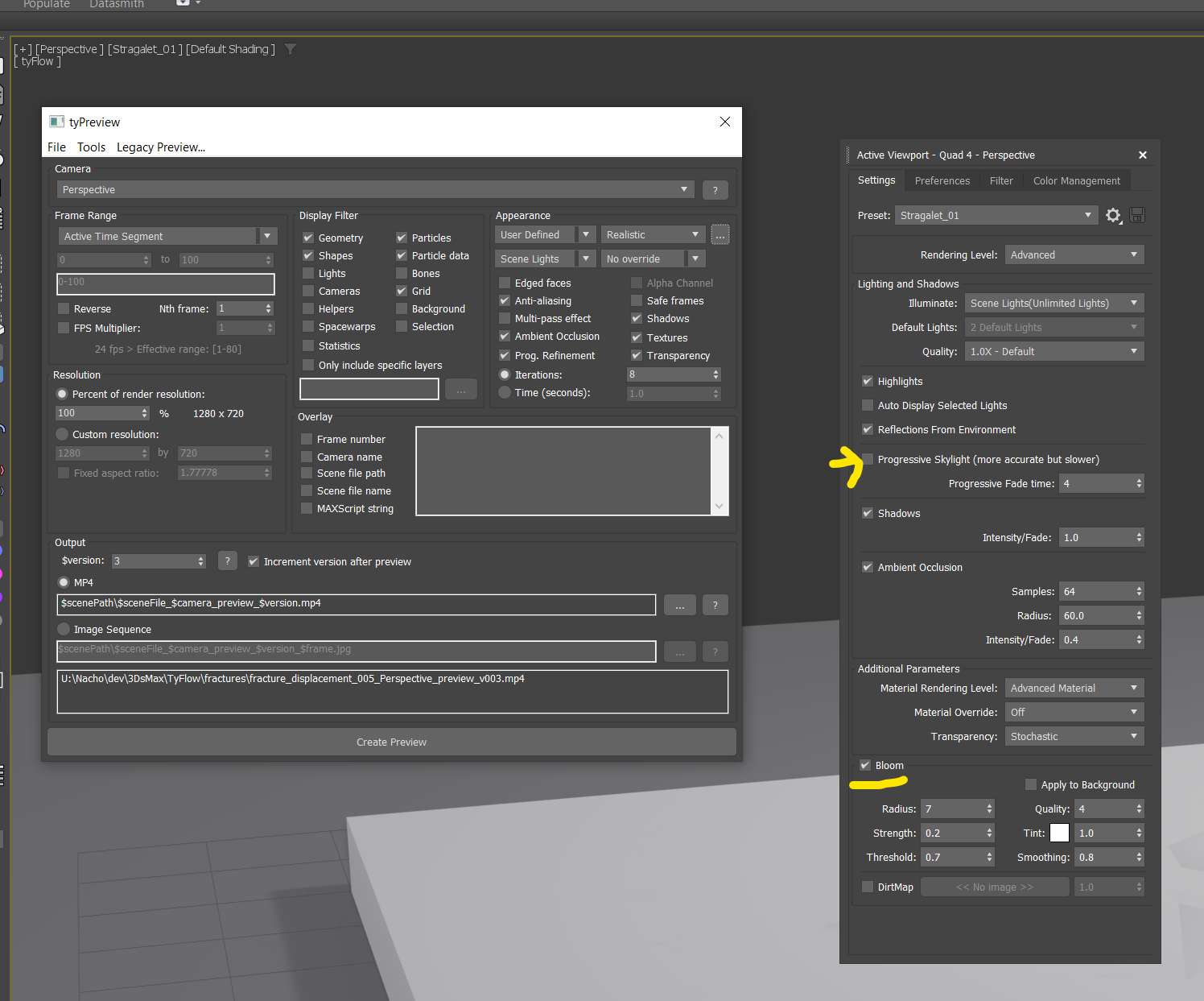

Typreview - houou - 02-02-2024 Could we include the Progressive Skylight button, and Bloom in the tyPreview? I usually want progressive iterations only for shadows but I don't want the skylight. And even if I set my own custom viewport configuration " get appearance from active viewport" won't get it right... It displays Realistic when it is not... I can force it to Default Shading, but then sometimes I loose the Bloom... Is a bit hard to control if I use this custom settings. Thank you! RE: Typreview - houou - 02-27-2024 Seems the setting inside TyPreview "prog.Refinement" overrides to "realistic mode" type of viewport. hence it messes whatever I set up on my preferences. I don't want realistic, I just want the progressive refinement for the shadows, i don't need the progressive lighting effect. RE: Typreview - tyFlow - 02-28-2024 tyPreview doesn't currently support those more advanced viewport features. Perhaps at some point in the future... |
