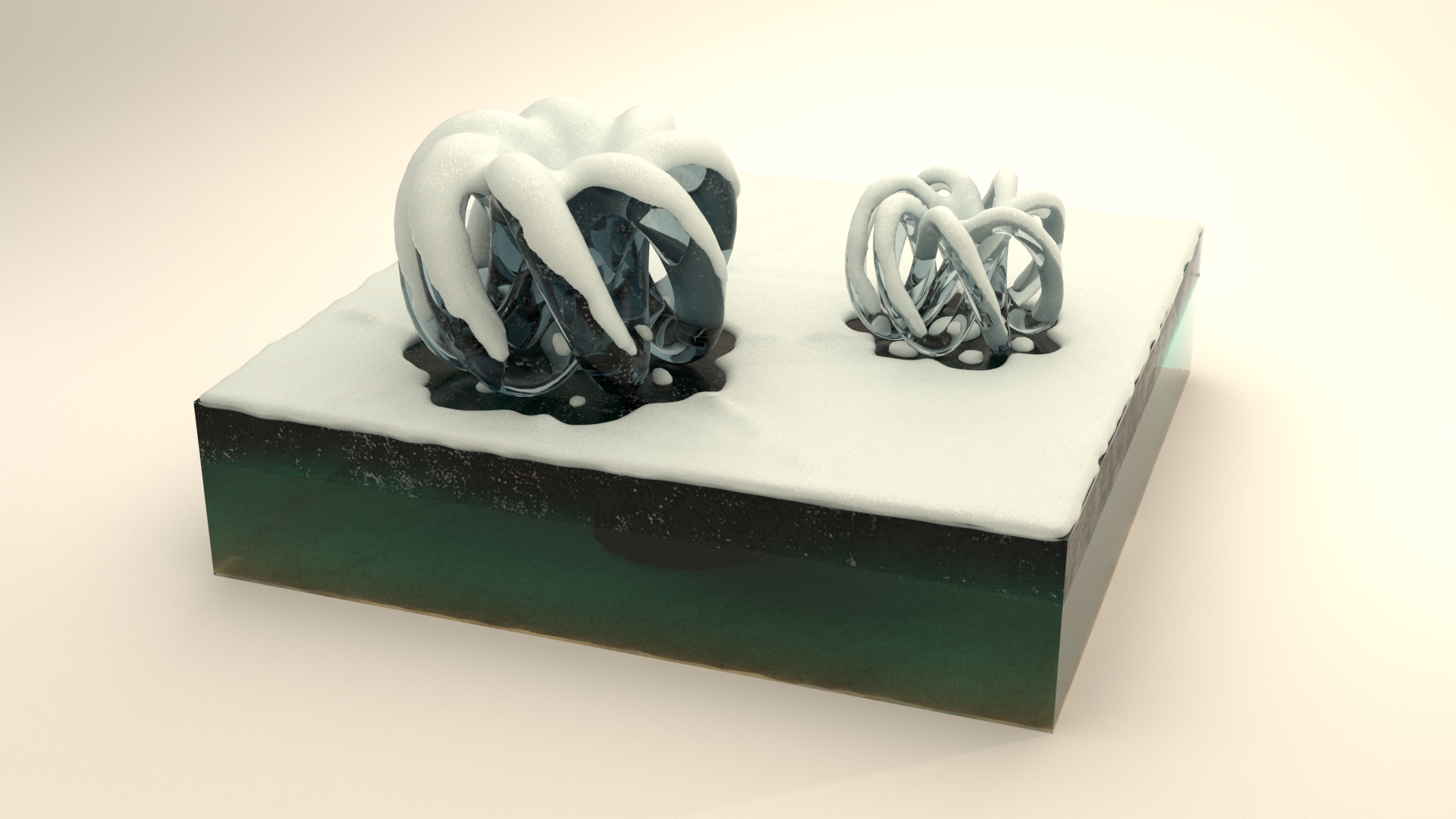

This so funny, I had the same picture as a reference, I came here via Google, because I wanted to recreate that.
I found a quick and simple solution without using a texture or script.
May not be perfect, but you can tweak it yourself, I will try to see if I can make a tutorial or post some pics!

[Image: materials_closeup.jpg]
[Image: materials_acc_flakes_800.jpg]
[Image: tyFlow.jpg]

tyFlow:
Birth 250.000
Surface Force 0.1, Distance 1.0 and Steering Angle 90.0
tyMesher:
Absolute 1.5
Mulitplier 1.2
Voxel size 1.2
Gaussian filter
Not perfect, but it works for some quick accumulation.
I would really love a real way that just stacks up flakes as soon as they touch another one or the selected surface.
https://linktr.ee/jaynl - Twitter and Behance for the latest renders!
