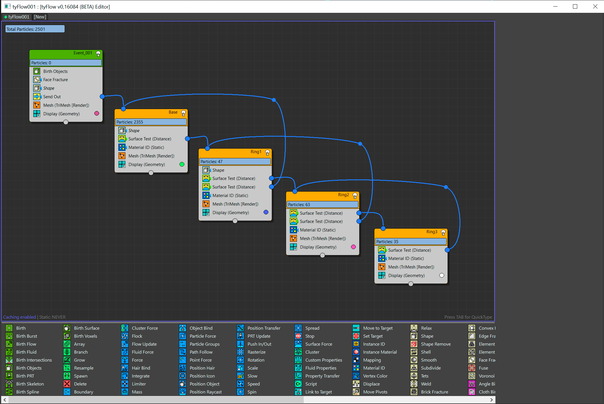

In the meantime i was able to solve it somehow. So no claims that i did in any smart way. I was just happy the system worked out as i wanted it to be.
Nonetheless if anyone is interested in and also the fact that i really don't like scrubbing through forums with only questions raised and no anwers posted when the problem is solved, i'll try to do it better.
In the Attachment is a screenshot of the flow and also the file.
Have fun and many thanks to tyson for that awesome tool!
