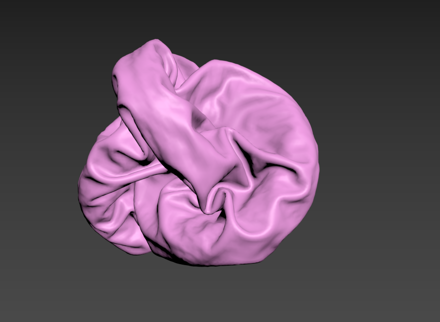

not sure if this is what you're looking for .. but i have got this result:
well thats what i was hoping for from this test.. obviously in a real scene id model the "shrink wrap" to fit the target properly. what was i doing wrong?

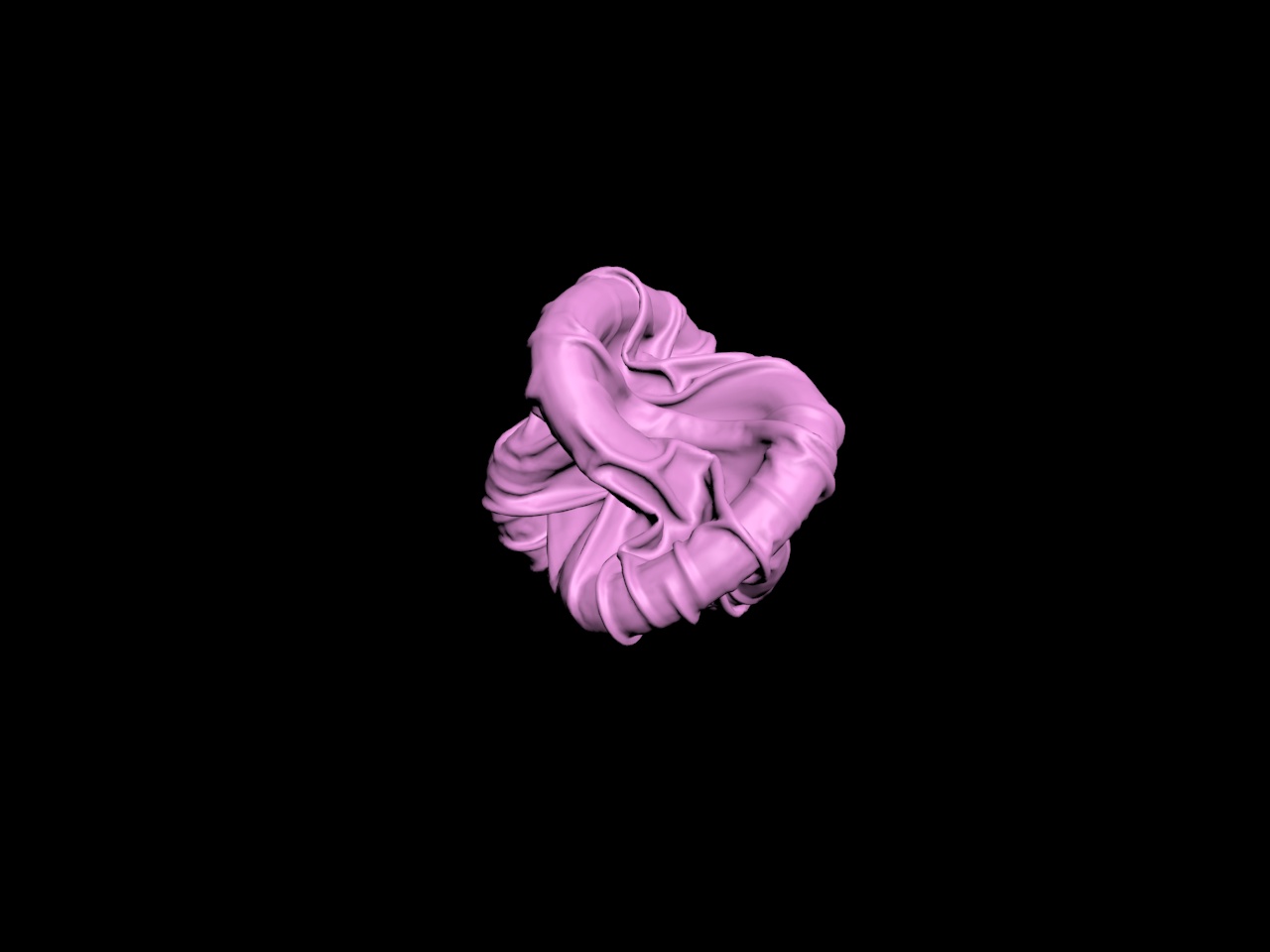

I was playing around in the file and noticed that the timing on the modify binding was not set to continuous which means, if I'm not mistaken, that it is only operating once and not re-iterating over and over, which is how a real shrink-wrap works.  Changing that gets something more like a shrink wrap.  Is that what you were looking for?  In either case, it looks cool.  Smile
The bias like Tyson said is like a rubber effect where the material is able to shear or shrink on itself.  In this example it would probably lessen the wrinkles that get caught if the self-friction doesn't hold them together.   Most of my shrink wrap work was with a more plastic material.
I also reduced the collision particle size because once the negative bias takes over they seem to shear weird.  This seems to look good, albeit it's a little slower.
Here it is with some negative bias:
 I'll attach that file next.  Hope it helps.

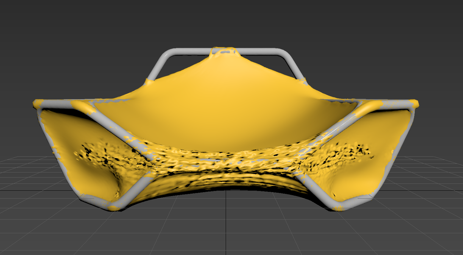

Hi!

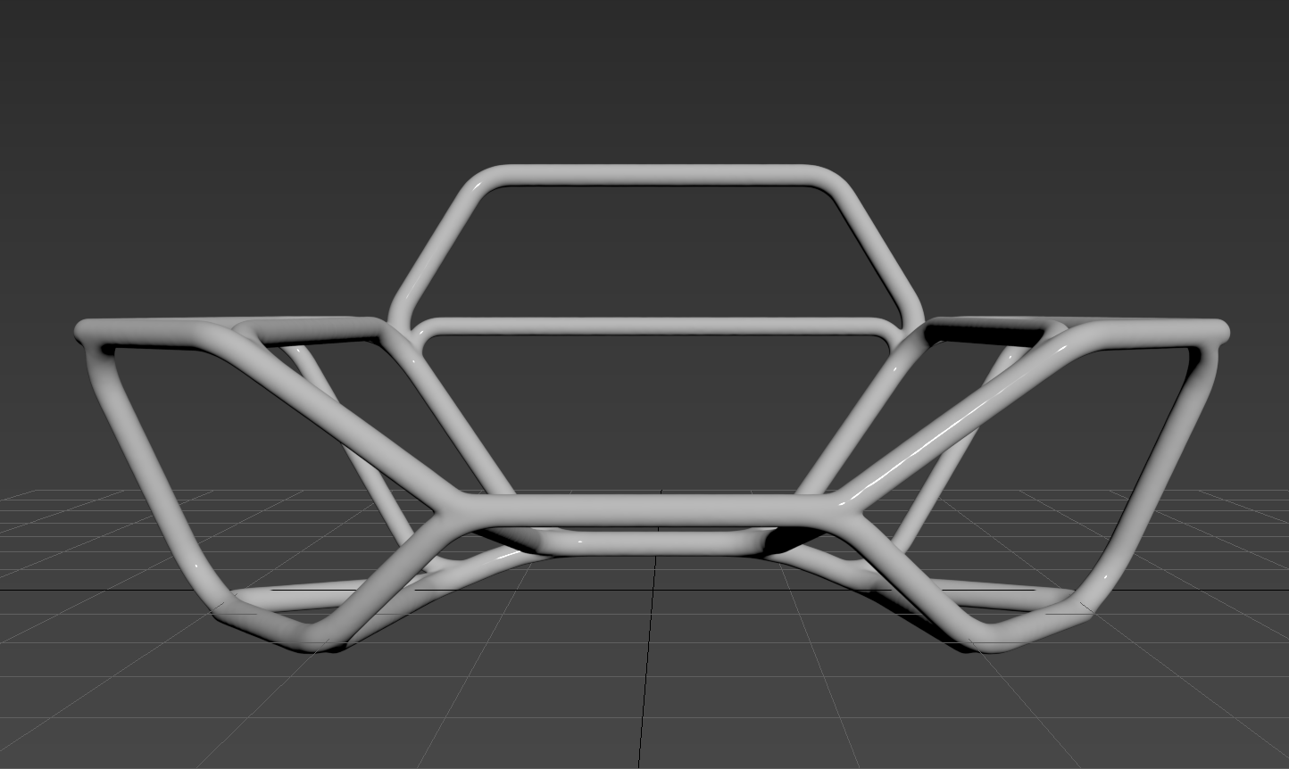

I have been struggling with shrink wrapping a tube chair I made for a while, and then found this discussion.
The negative bias shrink wrap MeHoo did is exactly what I need, so I downloaded the shrinkwrap04.max file and merged it with my file.

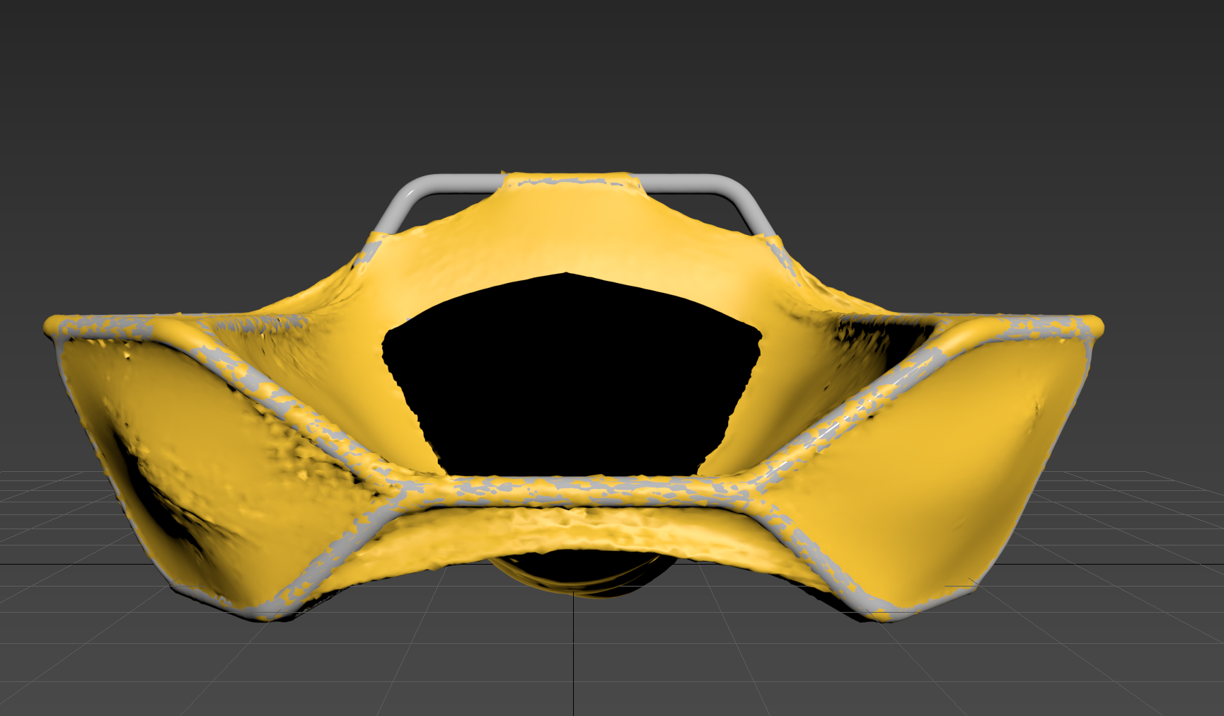

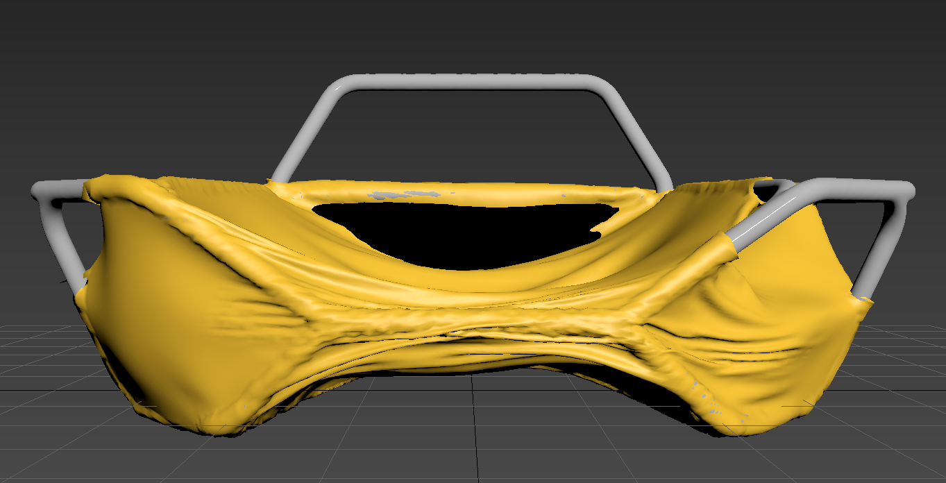

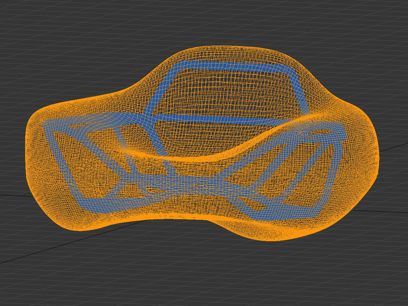

Due to the complexity of the chair I didn't manage to get a decent result. I modeled a birth object that's similar to the shape of the chair, but it's still not properly colliding with the chair and the cloth seems to be shredding. (see attachments)
I've tried adjusting some values such as the multiplier, the collision offset, and the inflation force - which slightly improved the wrap on some parts, but as you can see in collision-2.png it's still not at all working.
Which values should I adjust to solve this?
Thanks a lot!
