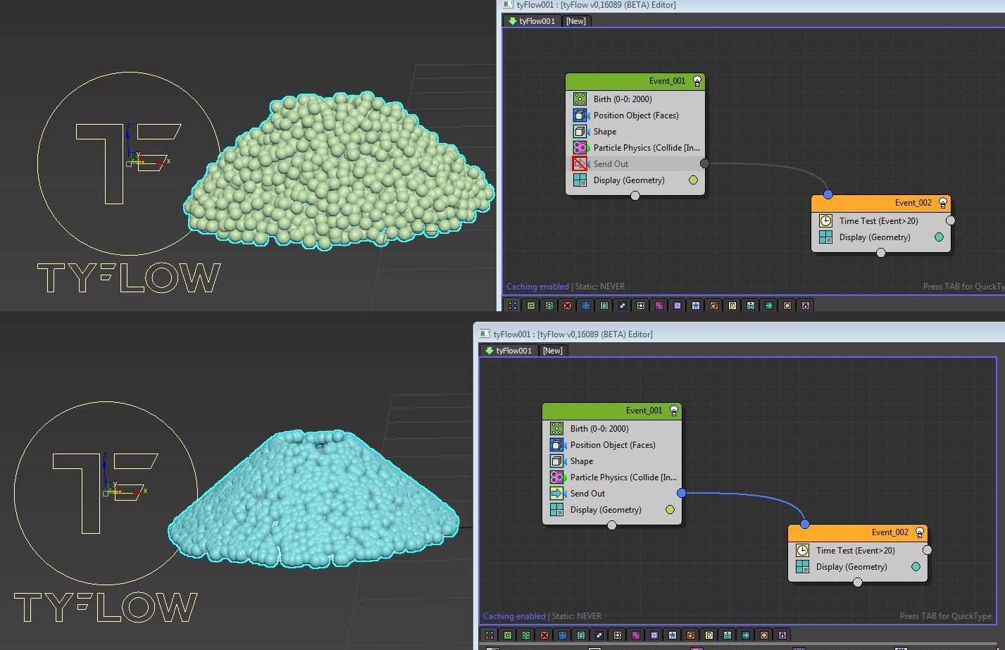

Hi Tyson,
first of all thank you for your amazing plugin!
I'm very new to Tyflow, hope you have the patience to answer my question...
I don't know if it's a bug or not, but it's driving me crazy:
as the image explain the Send Out operator seems to deactivate the Particle Physics operator...
I create a group of particles at frame 0 from a cone geometry.
I want they not to fuse each other so I add a Particle Physics;
now, as I want they stay in position for n frames, I add a Send Out to a new event with a time test.
The problem is that Send out seem to deactivate Particle Phisics...
Can you explain what am I doing wrong?
Thank you,
Man
I might be understanding wrong but what I think is happening here is that the 'send out' operation is happening instantly.
You need to put the time operator in the first event then drag off that into a second event, and it is in that second event that you should have all your fancy physics stuff.

Thank you Eli,
but the effect I nedded was to mantain the position given to particles by "Particle Physic" operator: attached to the cone, but not "fused" between them for n frames;
the way you did it the particles ar all fused between them (not acting as physical particles).
Have you another idea?
