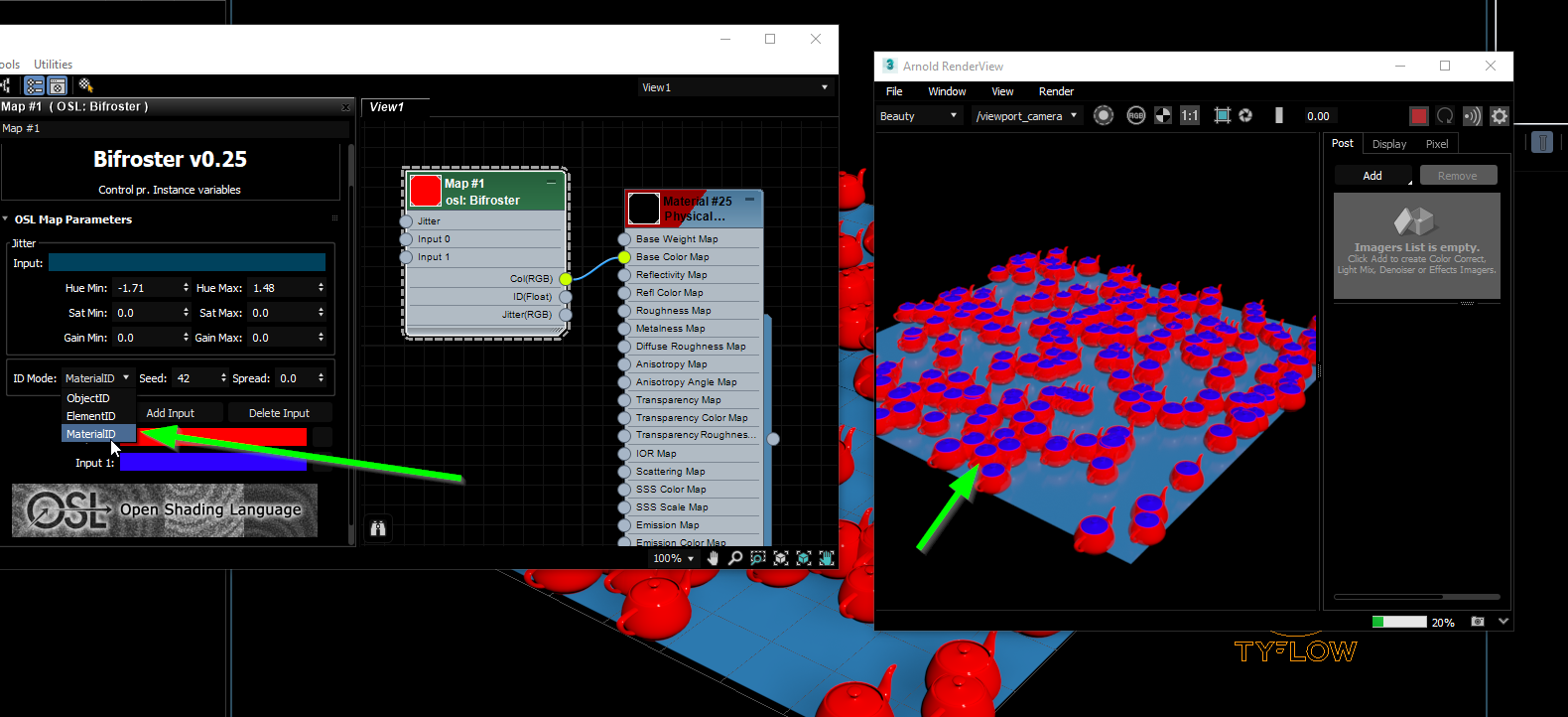

Arnold can render any and all IDs through Tyflow Particles.
I wrote a unified particle shader in OSL that can control Material ID, Element ID, Object IDs

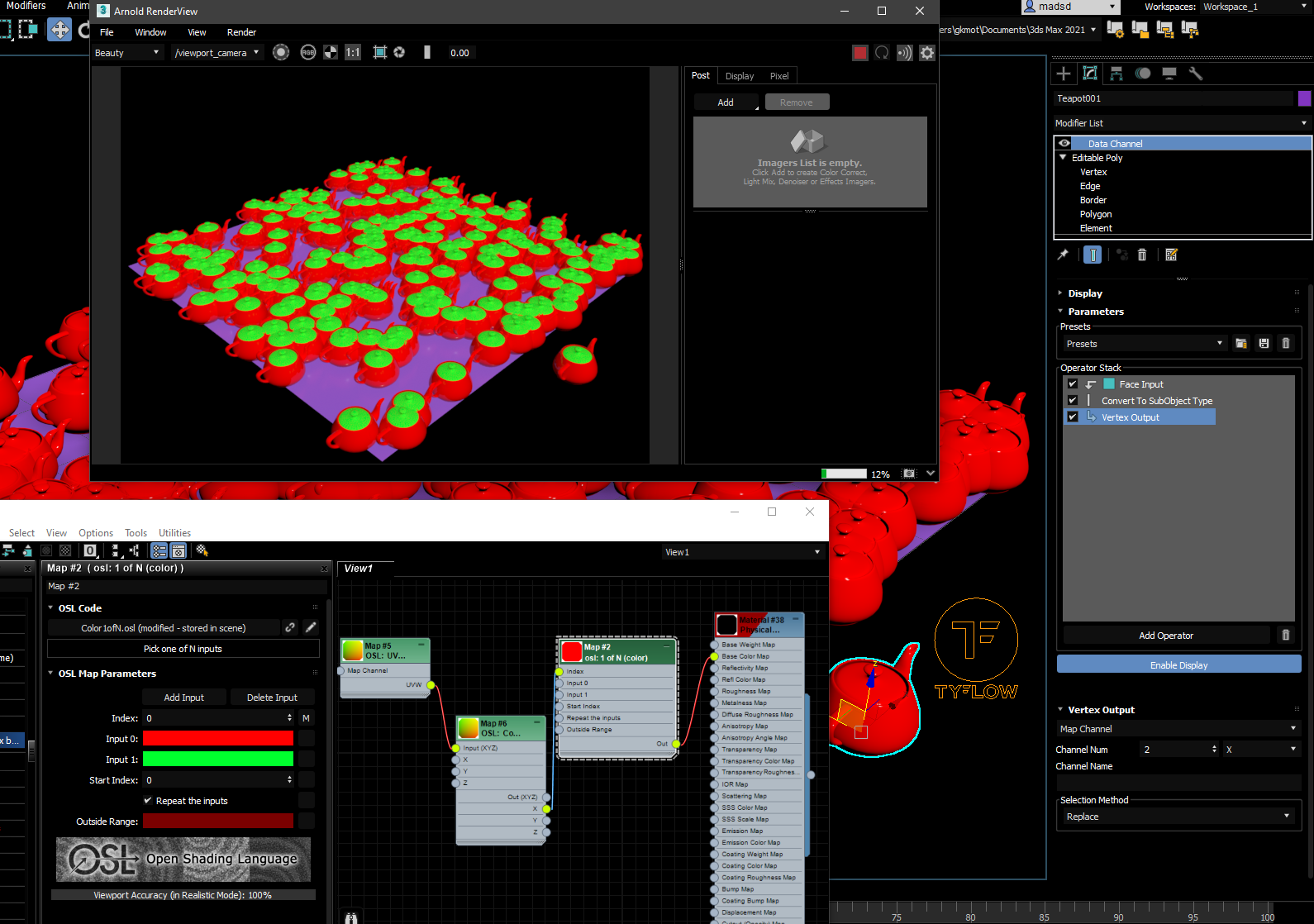

I will try see if I can get the multisub working with Arnold, I have not tried at all, I just know that Material IDs works perfect with Arnold and Tyflow through the tools I have written.
Here is another way to get it working right now.
You just generate a float channel in DCM and parse it to an array map, it returns a construct that is ready to be shaded with Arnold.
I also added a max file so you can see how to go about it.
Since the Multisub seems broken, I just confirmed this, it is the multisub that is broken, it is not "working with material IDs" that is broken - Ill file a note on the developer slack channel so they know this is an issue and that users seeks to be able to use the old way of doing things.
.max   Arnold_mtl_Id_Tyflow.max (Size: 1.15 MB / Downloads: 426)
