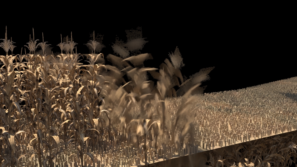

I've put up the file in question for you to check out here: www.geoffkornfeld.com/TyFlowIssues.zip • There are three corn objects distributed all over the field by TyFlow. • TyFlow is set to switch to the same corn objects -but with their animation turned on- when they are inside a moving box. • The animated TyFlow instances do not motion blur. But the original objects (off screen to the side) do. • I've deleted the model of the harvester combine from the scene, since it's not relevant to my problem. The box object is what actually triggers the switch. • I am no longer using objects with cache, as I originally stated. I had switched to cached objects because I thought it might solve the problem.

I'm not sure why VRay is being grumpy about your setup...nothing seems inherently problematic about it. Try this: in the interfaces rollout of your tyFlow object, disable the VRay interface. You're not rendering as instances so it's not needed anyways. The result I get is a render with expected moblur.... |
