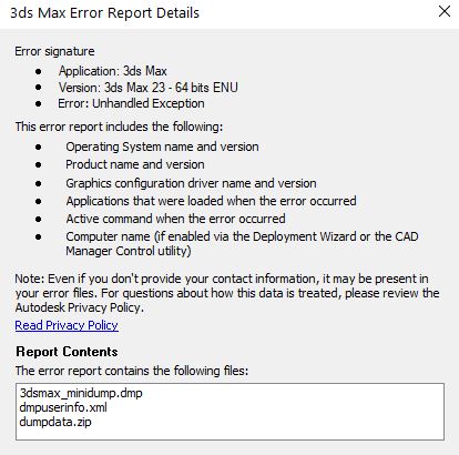

Hi Tyson,
I have installed the version of tyflow that you have recommended and the cuda DLL, 3ds max closes. I'm sending you a screenshot of the error in case that helps you.
#11
Nope, that doesn't help Smile
Please read through this:
http://docs.tyflow.com/feedback/bugs
