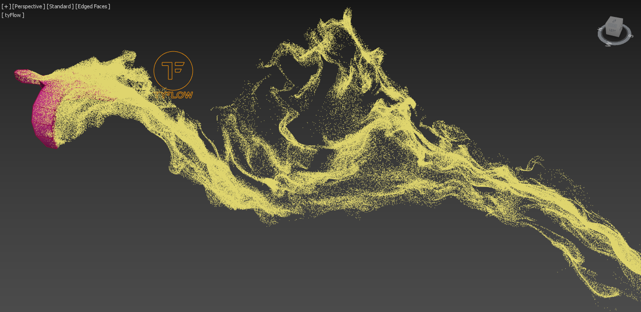

definitly not as good as your image, but it looks similar, by utilizing cluster and cluster force and some turbulence wind force.
.max   fluidSmokeLike.max (Size: 684 KB / Downloads: 364)
