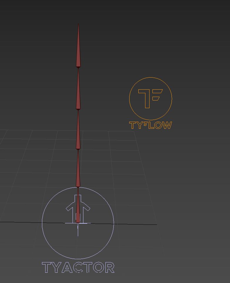

I'm trying to get my head around actor rigid bodies and physX binds by making a tail wag effect.

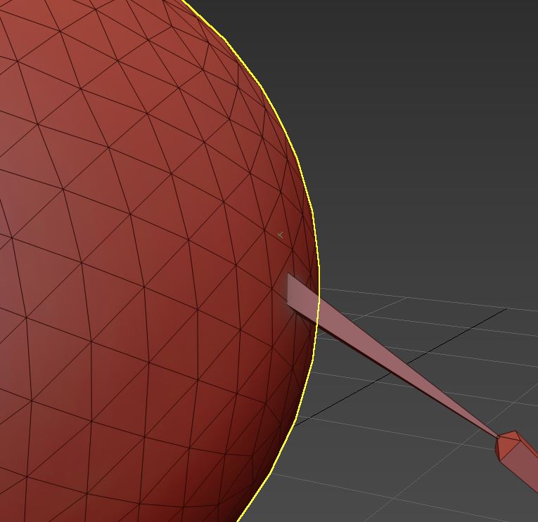

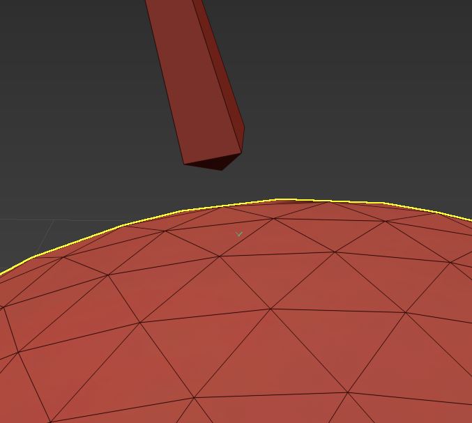

I has been successful although i cannot get it to stay bound with the rotating sphere. It should stay where the green point is but it slides in and out of the sphere.
I feel i may have gone wrong somwhere in this setup.
any help would be appreciated!

Any PhysX particle Object-Bound needs to be set to kinematic with a PhysX Switch operator.
(06-17-2021, 09:03 PM)tyFlow Wrote: Any PhysX particle Object-Bound needs to be set to kinematic with a PhysX Switch operator.
Oh wow, now it 1000x better. You are the man, Tyson.
Thanks for your time! This is such a powerful techinique.
