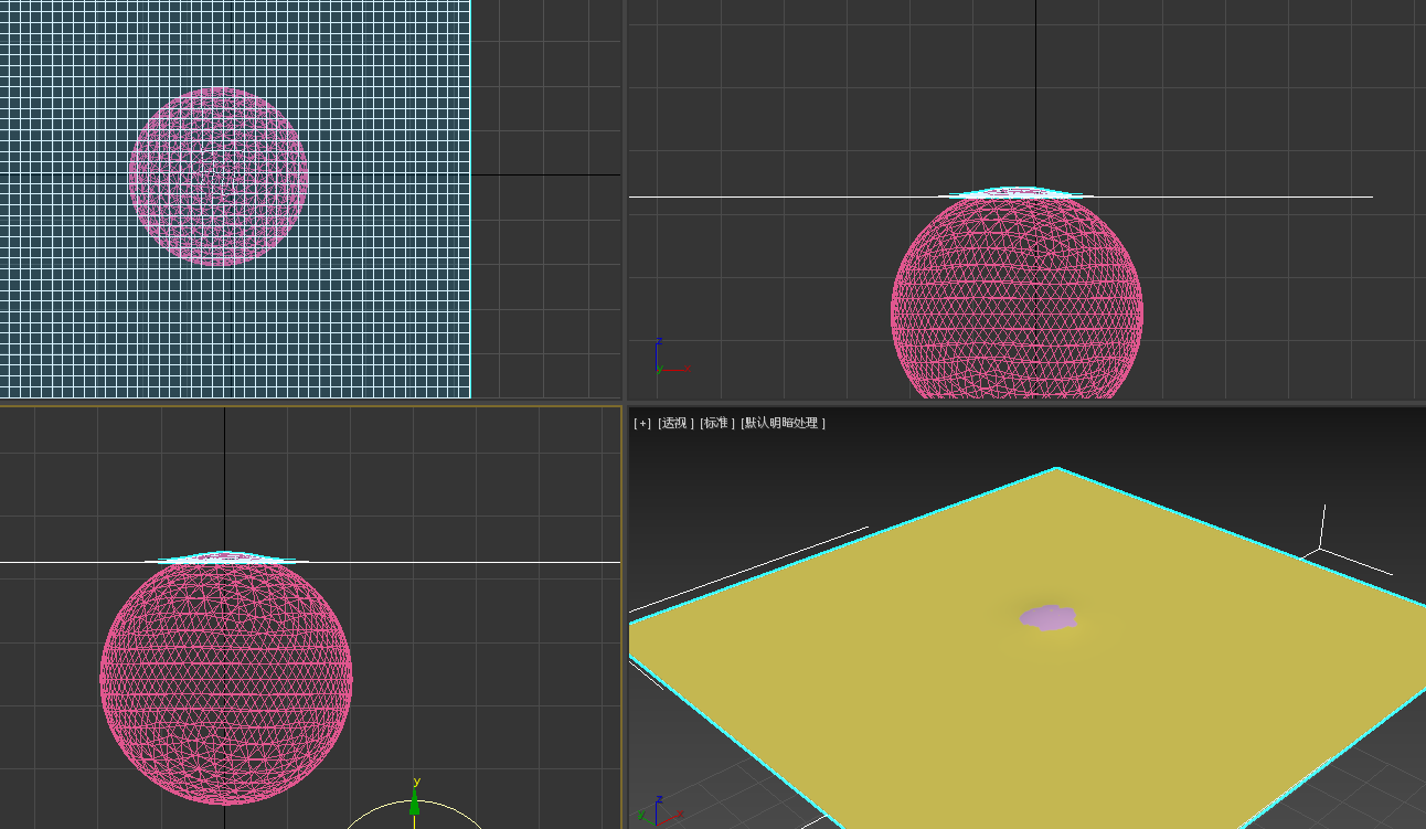

As the model moves quickly and collides with the cloth, it moves through the cloth.
I tried to increase the number of time step,solver step,repulse step,simulation substeps but it didn't work.
How to adjust those parameters?

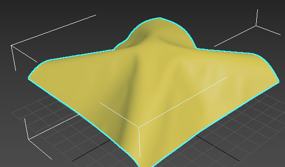

I actually opened the operator. But I am new, so I re-read the document when I saw your reply.
The problem was solved after I tried to increase the thickness of the cloth in the CCCS.
Now I know that when the model moves too fast and passes through the cloth, I can increase the thickness of the cloth to give the solver plenty of time to calculate.
