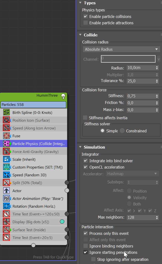

Checking "Ignore Start Penetrations" of the Particle PhysX helped. But some move still constantly to the sides out of the picture...

Yes, I meant and used Particle Physics (it was just a misspelling).
Attached screenshot
