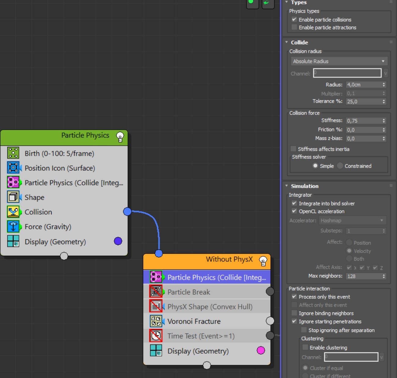

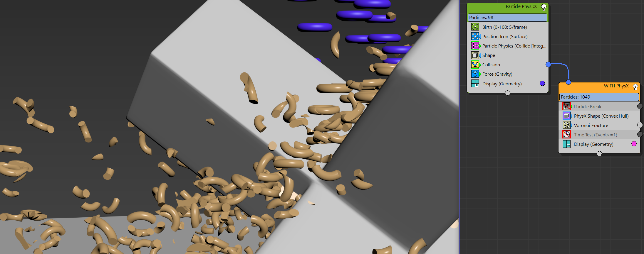

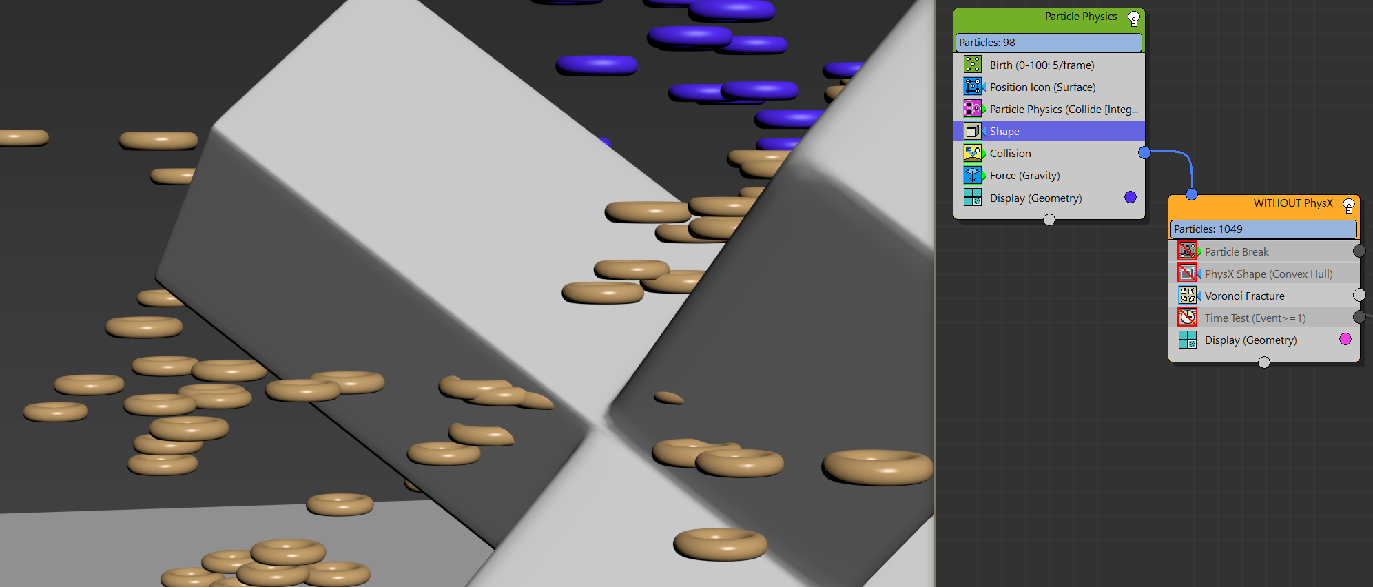

Attached my test screenshots and scene:
I wanted to have particle shapes to be fractured.It only worked with PhysX.
Can you see, what I'm doing wrong?

If I understand your screenshot, you want Particle Physics to collide, and then in next event to be fractured?
You should enable "draw collision shapes", in Particle Physics operator, so you can see how large or small collisions shapes are, so you can adjust them.
Take a look at the attachment.
Is that what you want?
You will see I enabled "draw collision shapes" in both event, so you can see how big the are (they are smaller when object is fragmented)
I sort of did it, but I repeat, for this type of simulation (on fragments), PhysX is way better, and much more precise.

Thanks! Smile
needed another particle physx operator in the second event to let the voronoi work
