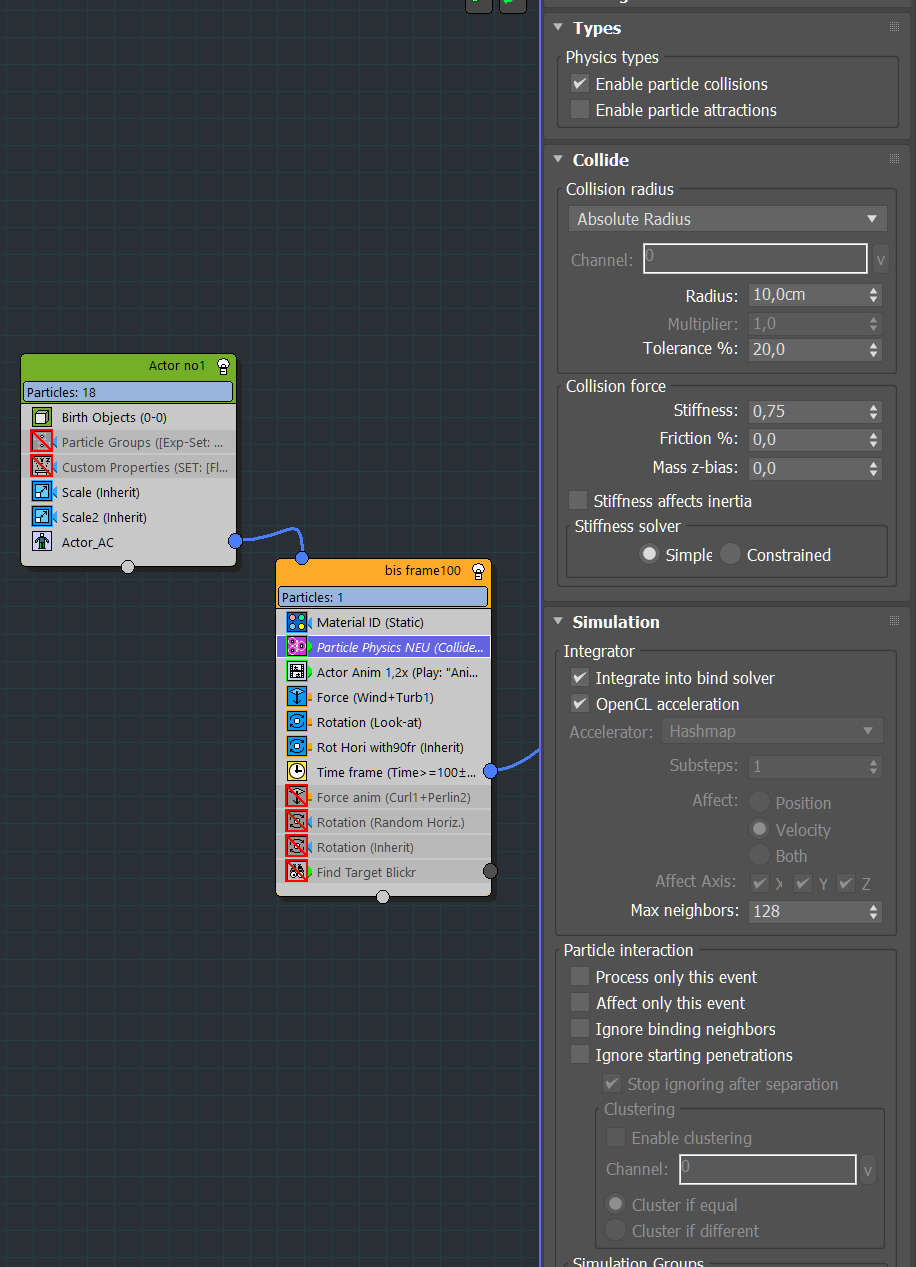

Hello,
once again at the topic:

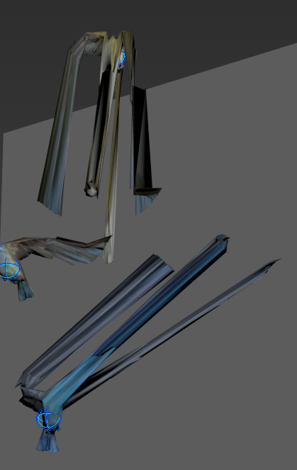

If actors are born in different events and I'm unchecking "process only this event", they get distorted.
I played with all settings, didn't find a reason...
Thanks for help

If you uncheck that, then the operator will affect the (18) rig particles in your first event. You don't want that

Okay, that makes sense!
So if I would set all particles in the flow right in the next event after their actor birth to one simulation group or export group, it should actually work, if I filter by that… I will try out.
