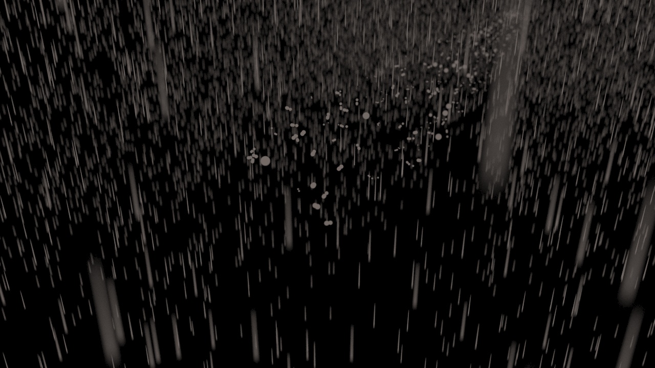

Well I meant and render as well. When I render I see drop and spheres, just like in the view.
Can you post a screengrab of what you're seeing in your render? Also more info like what renderer version you're using.
https://www.dropbox.com/t/5MbYBFTuYwQEYAmu
It's looking like this - all the particles are spheres

Very bizarre....VRay GPU 5.2.2 here and still no issue....
Can you load the attached file, go to frame 25 and hit render and tell me what you see? Still all spheres? I've attached what I see.

(05-16-2022, 05:23 PM)tyFlow Wrote: Very bizarre....VRay GPU 5.2.2 here and still no issue....
It's still all spheres.
