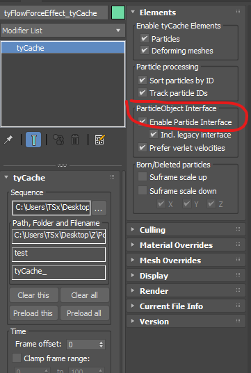

For emitting from a tyCache, you just need to enable the tyCache's particle interface in the interfaces rollout.
#17
(07-12-2022, 03:02 PM)tyFlow Wrote: For emitting from a tyCache, you just need to enable the tyCache's particle interface in the interfaces rollout.
You mean this?
#18
Yes.
#19
But its checked, without phoenix emitting anything from the particles.
You think there could be some other setting hindering it?
Probably me again changing settings Sad
#20
