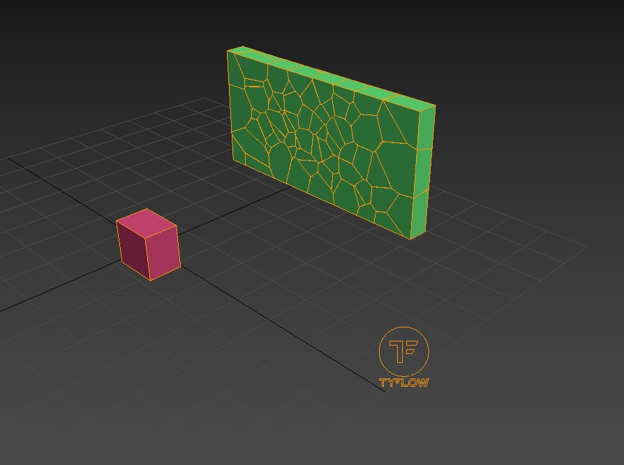

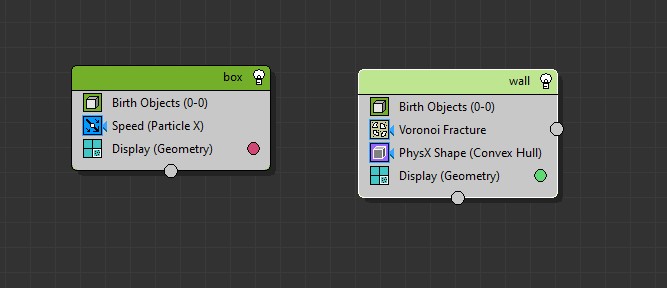

I need help with one TyFlow project. I want to simulate movement of the box with TyFlow (first event). This box movement will collide with wall. Wall is a subject of second event. In second event is voronoi fracture and physX Shape. I want put box in collide objects of wall (I want that box brake the wall). How can I do that?
I want (if is it possible) do that without PhysX Shape in first event because it is easier to make more complicated movement (no gravity). If it is not posible solution with PhysX will be also ok.
