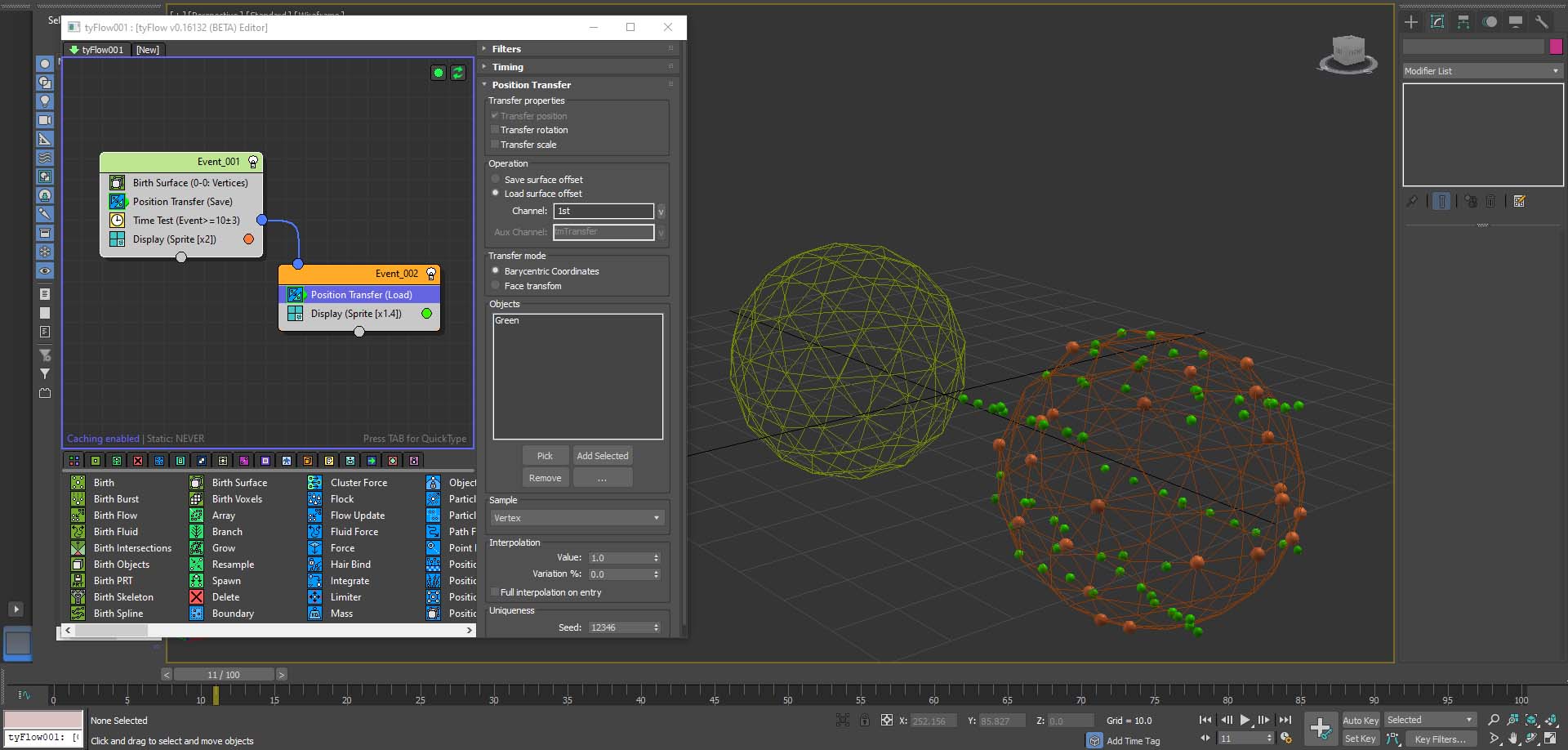

   First of all let me thank you for your Brilliant plugin.Then I faced a problem .I want to morph from one dynamic character to another one with same topology and animation. I found Position Transfer operator and tyParticleSkin Modifier seem good for this job if I didn't make a mistake.
   I searched and tested but I can't find any solution. Can anyone help me to solve this problem or suggest a different solution?

Yea, Position Transfer could work for something like that. What's the issue you're running into?
(08-10-2022, 01:20 PM)tyFlow Wrote: Yea, Position Transfer could work for something like that. What's the issue you're running into?
My Problem is when I save particle position based on vertices and load in other Position Transfer. Particles never go to corresponding target vertices and stay in weird position. BTW If I have problem in adding operators in proper way ,suggest me the right one.

See attached....
.max   posTransfer.max (Size: 796 KB / Downloads: 484)
(08-12-2022, 04:54 AM)tyFlow Wrote: See attached....
