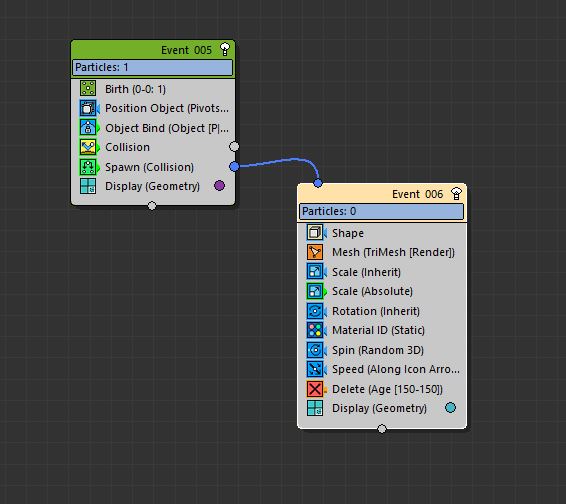

Really simple question .. I have a Collision sending out to a Spawn when it collides with a mesh. I want the particle to collide with the mesh multiple times but I can see no option to prevent the Collision from sending the particle out on the first collision. So I end up with the first collision working perfectly, but then no particle in the Event holding the Collision to trigger subsequent Spawns.
Where is this setting?

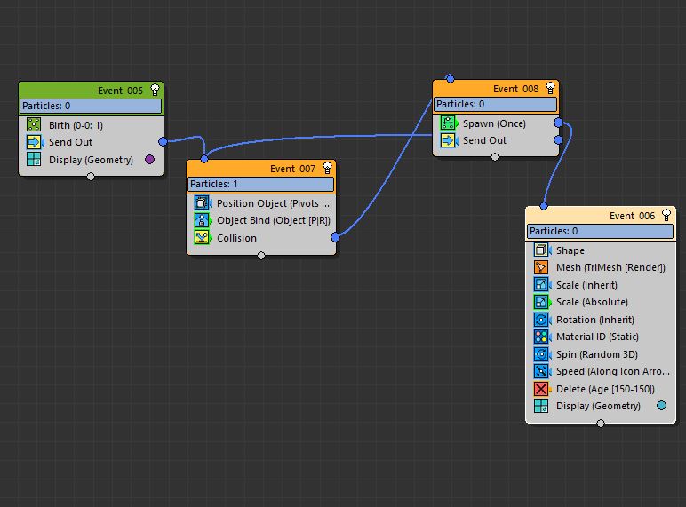

I'm coming from ParticleFlow and starting from zero here.
If I link it up in a similar way to PFlow, I get particles continuously birthing and no second collision.
I know there must be multiple ways to do this in Tyflow. Apologies for the slowness, but could you please expound a little?
