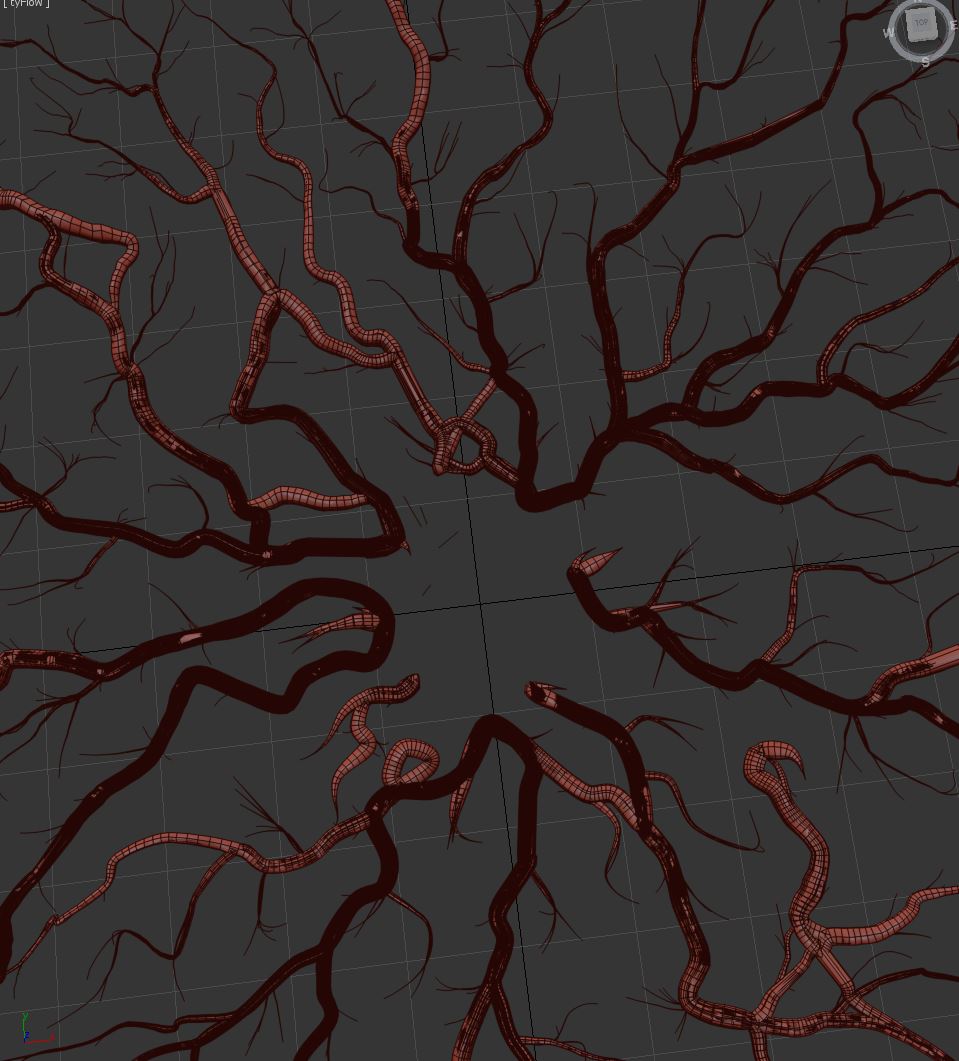

I have been testing the shortest path option and using the same settings in your facebook video, it works but i always end up with loads and loads of overlapping splines. this is killing my render times and i don't know how to get rid of them.
Don’t send anything out of the operator and the paths won’t be duplicated (I believe this is noted in the docs). Alternatively, add a Spline Relax modifier to the resulting splines to reduce face overlap.
(09-05-2022, 10:57 PM)tyFlow Wrote: Don’t send anything out of the operator and the paths won’t be duplicated (I believe this is noted in the docs). Alternatively, add a Spline Relax modifier to the resulting splines to reduce face overlap.

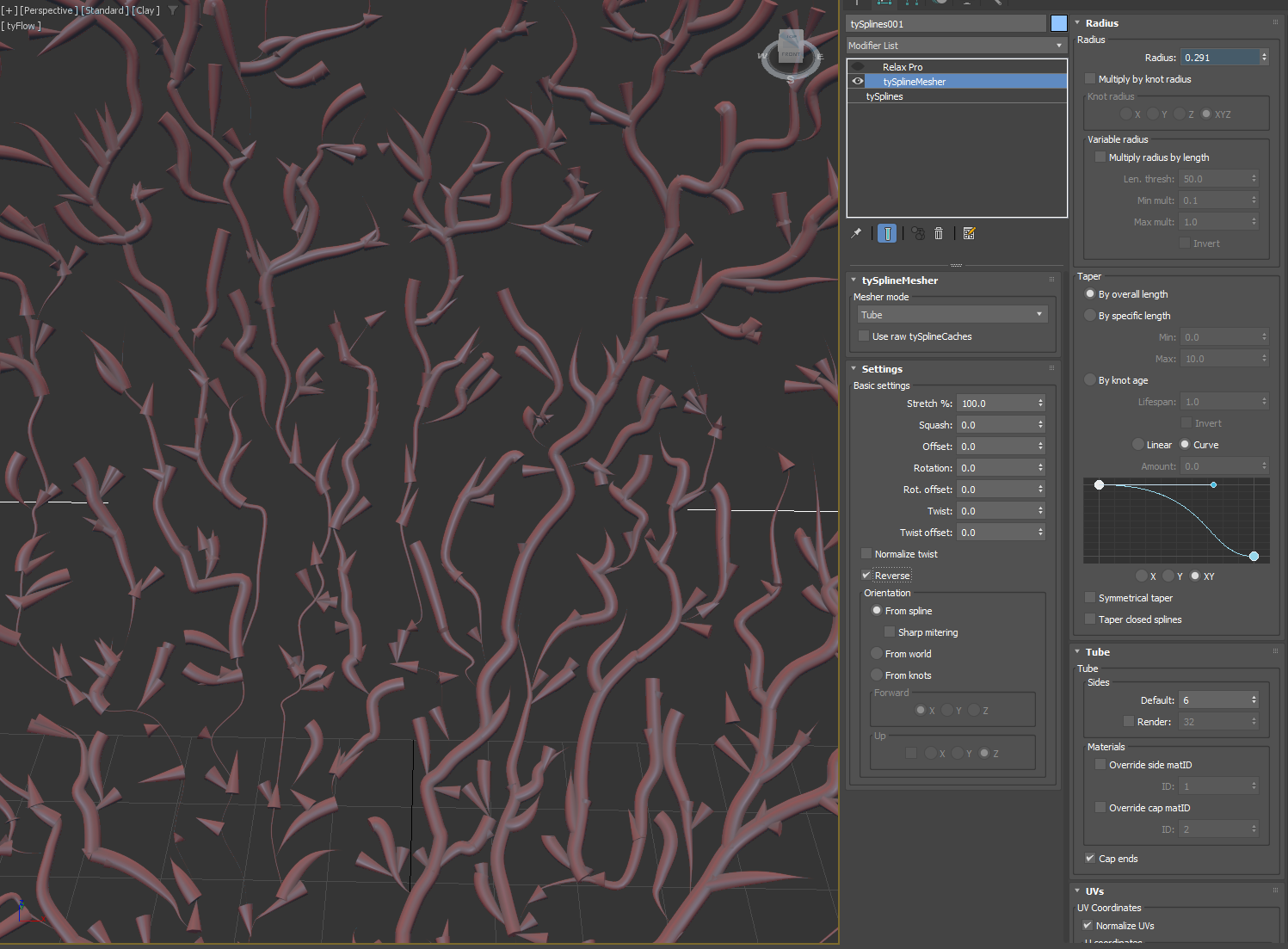

That seems to have stopped the overlap, so thank you for that. But now i get lots of tapering going the wrong direction, some seem fine and others are thick at the ends. any idea? cheers

As for the tapering when particles are not sent out....the tySpline object doesn't really know what direction any of the splines should be in...it just connects them together and picks a direction to taper in (by default, by sorting particles by ID). You can force a direction by sorting the surface-born particles by distance to the target object using the tyVertexOrder modifier.

Attached is a scene showing how to do the vertex ordering/tapering thing. One thing you'll notice when you open the file....a couple of the splines at the top left seem to have inverted tapering...but it's actually not inverted, the splines are just so long after welding that they stretch all the way around the sphere to the other side where the tapering ends at the exact opposite location on the sphere....I'm not actually sure how best to mitigate this at the moment...perhaps a new tapering mode could eventually be added to the tySplineMesher modifier - one that tells splines to taper towards/away from an object. I could see that being useful.
I've also enabled spline radius multiplication by length in the tySplineMesher modifier, so that tiny splines don't have a big radius which connects to the tapered ends of larger splines.
