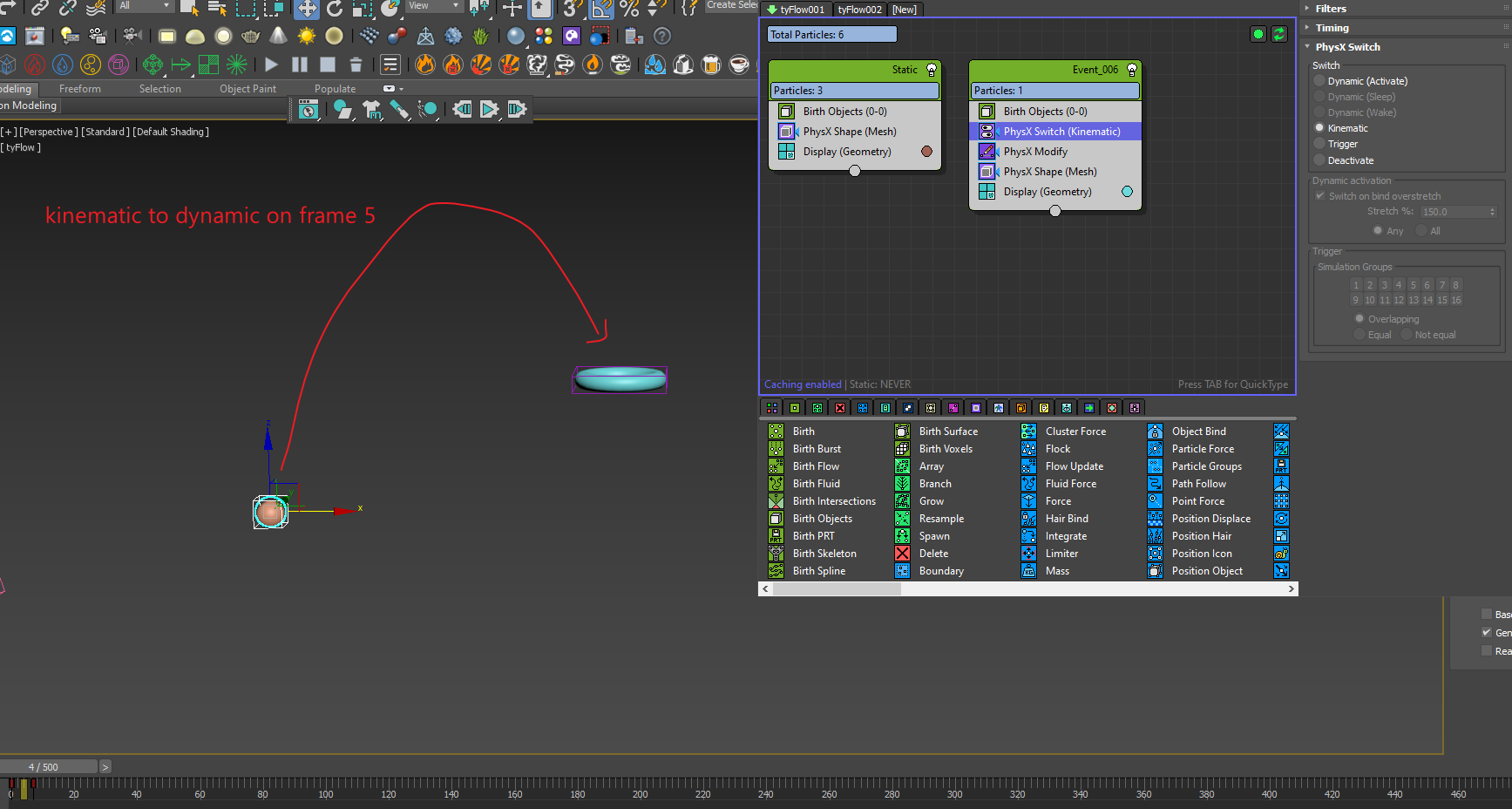

Hi all, i just want to have a simple basketball throwing out by using kinematic to dynamic in TYFLOW.
previously i using 3ds MASSFX to do this action, but when going to duplicate some object will be keep lagging, that why i change to TYFLOW for the workflow.
so, back to the question how to use TYFLOW from kinematic switch to Dynamic , thanks !
You can use time test for that.
So, in the initial event it should be:
PhysX Shape
PhysX Switch (kinematic)
Time test (at frame 5).... all this connected to next event that only have:
PhysX Switch (dynamic)
One note:
In your screenshot I see that PhysX shape is bellow, PhysX switch... PhysX shape should always be above every PhysX operator, because it's initialized in PhysX shape.

HI Thanks for the correction, i try the method but in the end still cannot work, please advise me got any step wrong?

Ahh I see...
PhysX don't inherit velocity from birth object, so I turned that off, and added Object Bind (with verlet integration (so it transfer velocity).
I also had to reduce gravity quite a bit, because I felt it was too strong, and I've played with 3 settings (restitucion, statick and dynamic friction), in both PhysX shape, and Tyflow ground floor settings, in order to make them bounce and have friction as I liked.
I added another collision object just for fun. Smile
Check out the attachment, and let me know if that's what you wanted.

Hey , thanks for your help, finally i understand why.. haha
you are so good! Big Grin
