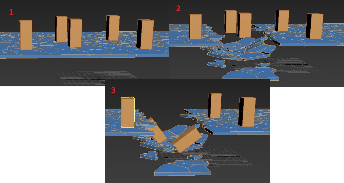

How to make the effect with tyflow as in the attached picture?

Ok, I'll try to describe in more detail.
I would like the objects (B) that are within the scope of the Voronoi fracture to interact with these fragments of Voronoi fracture (as in figure 3).
Currently, the objects (B) remain in place (as in figure 2). I don't know how to do this.
Can anyone help?
Maybe I will describe it differently: there is a tree on the ground. The ground collapses and the tree falls into the hole.
Many ways to do it.
Attaching you the way I did it, with few additions (like tree swinging and braking with force)
Feel free to ask, if anything is unclear in my flow.
.max   ground_collapse_tree.max (Size: 752 KB / Downloads: 175)
This is what I wanted to get. Thank you very much.
