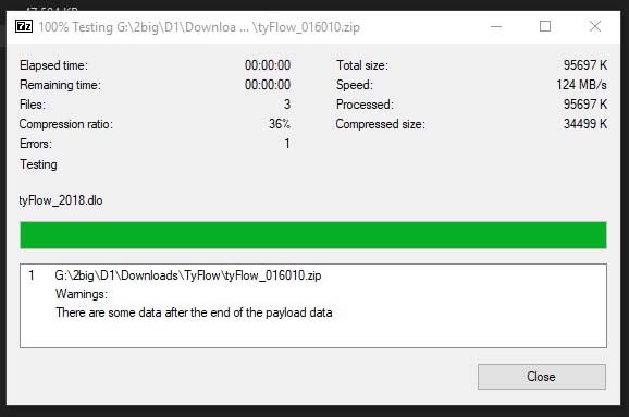

As I told you in the PM, I have some doubts on the files I download.
As far as I unzip the files via the windows util it seems ok, but if I unzip it using 7zip I get an error.
I don't know, maybe is this causing my problems!
#23
Can you try extracting with winrar? That's what I used to zip them.
#24
Extracting the file with wrar gives no error, but max keeps crashing.
Tell the truth, you are packing a special version of tyflow that crashes max specifically for me....  Big Grin
