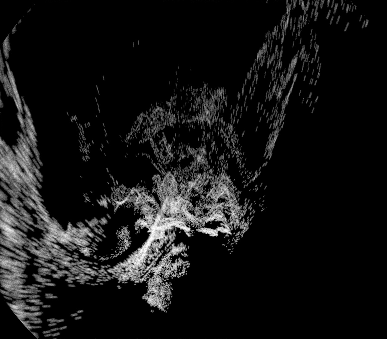

Anyway, hope the attached (super simple) scene can be used as illustration: what export settings are required to get these points rendered with motion blur?
And here's an example closer to a real world scene:
exported as VRayProxy with age, position, velocity and color channels enabled.
Motion blur works fine in this case, but these are spheres, not points.
.max   tyFlow-MoBlur.max (Size: 912 KB / Downloads: 348)
In your scene, when I enable motion blur in the VRay render settings as well as the VRay camera, I get motion blur on the particles rendered as points using a PhoenixFD Particle Shader object.
