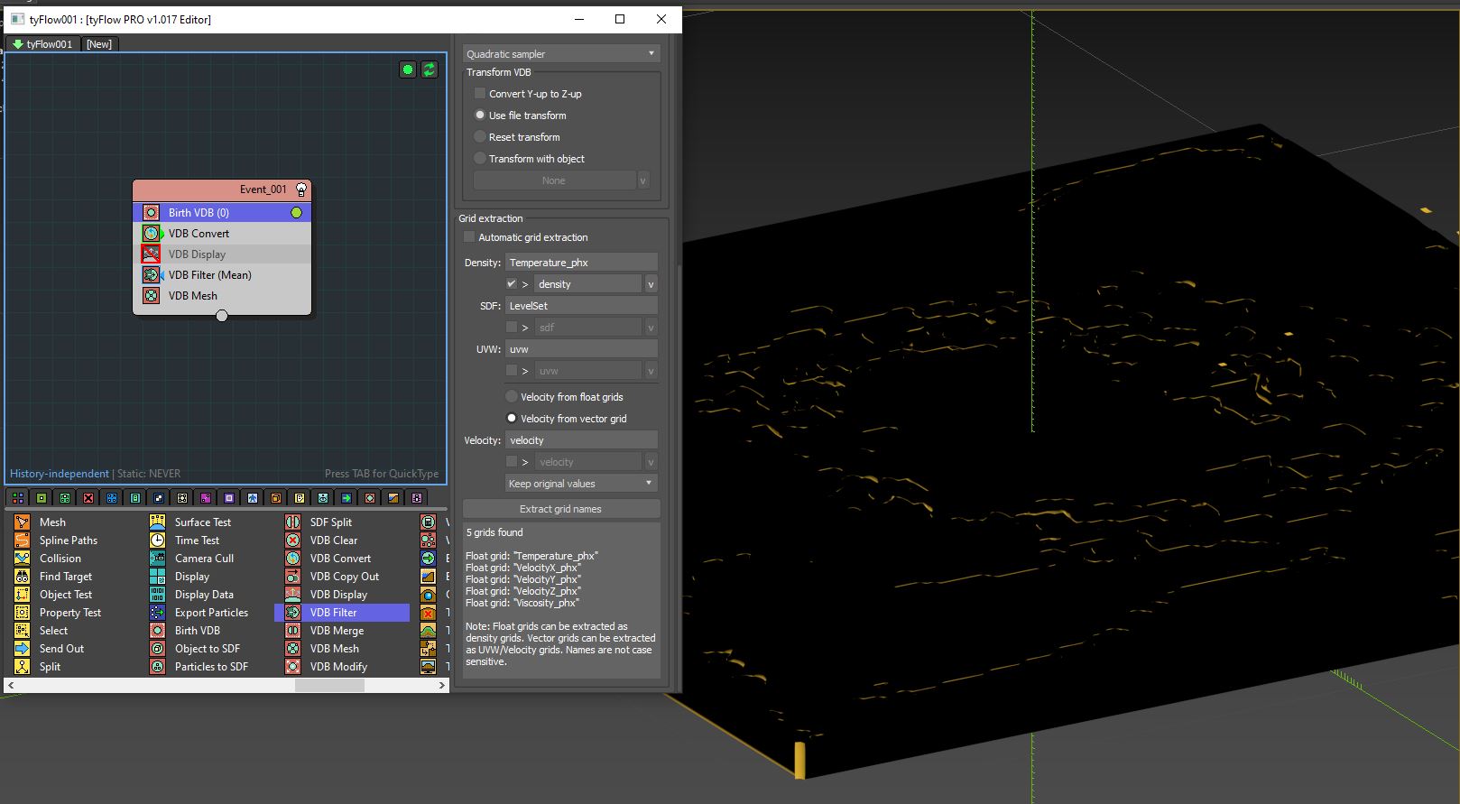

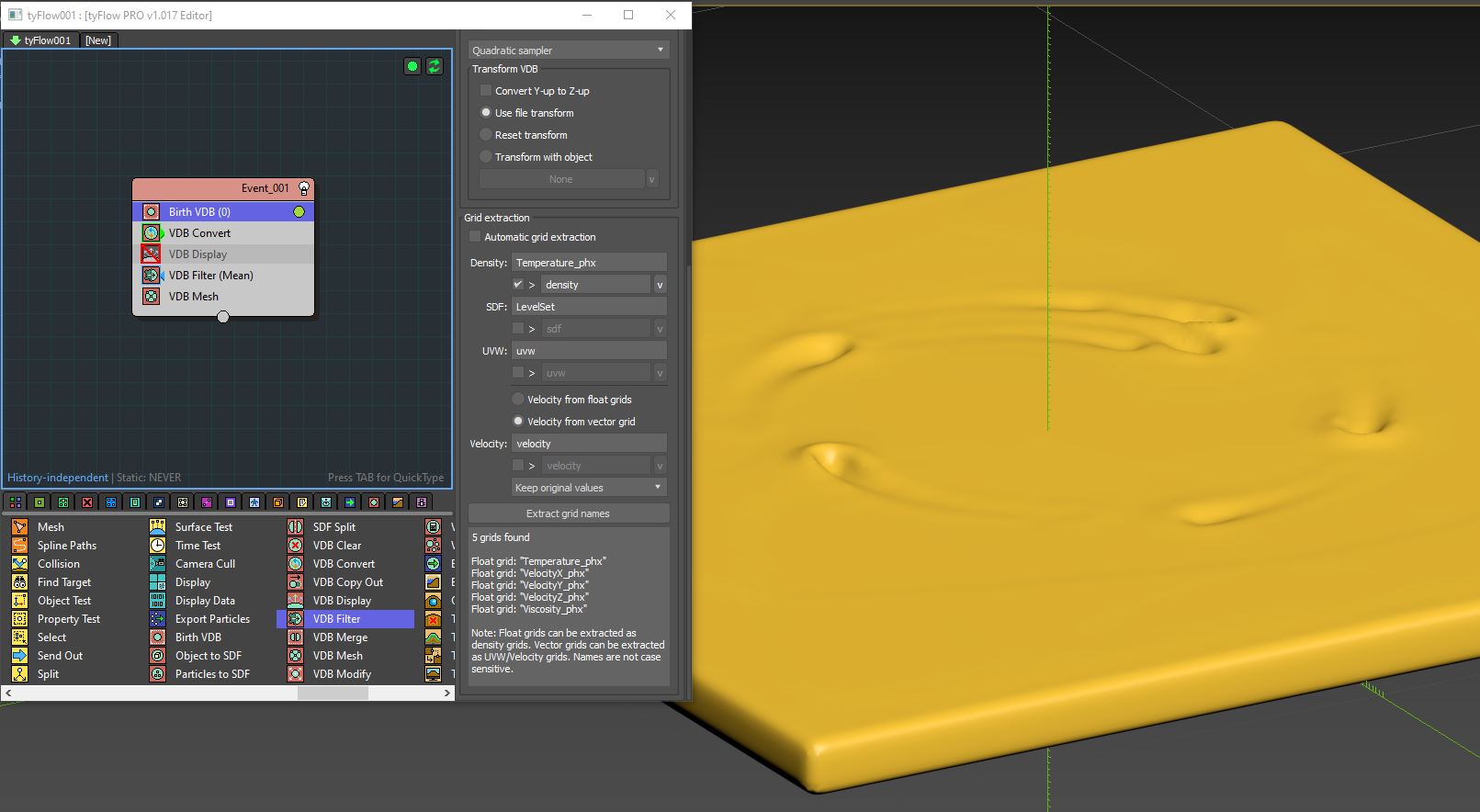

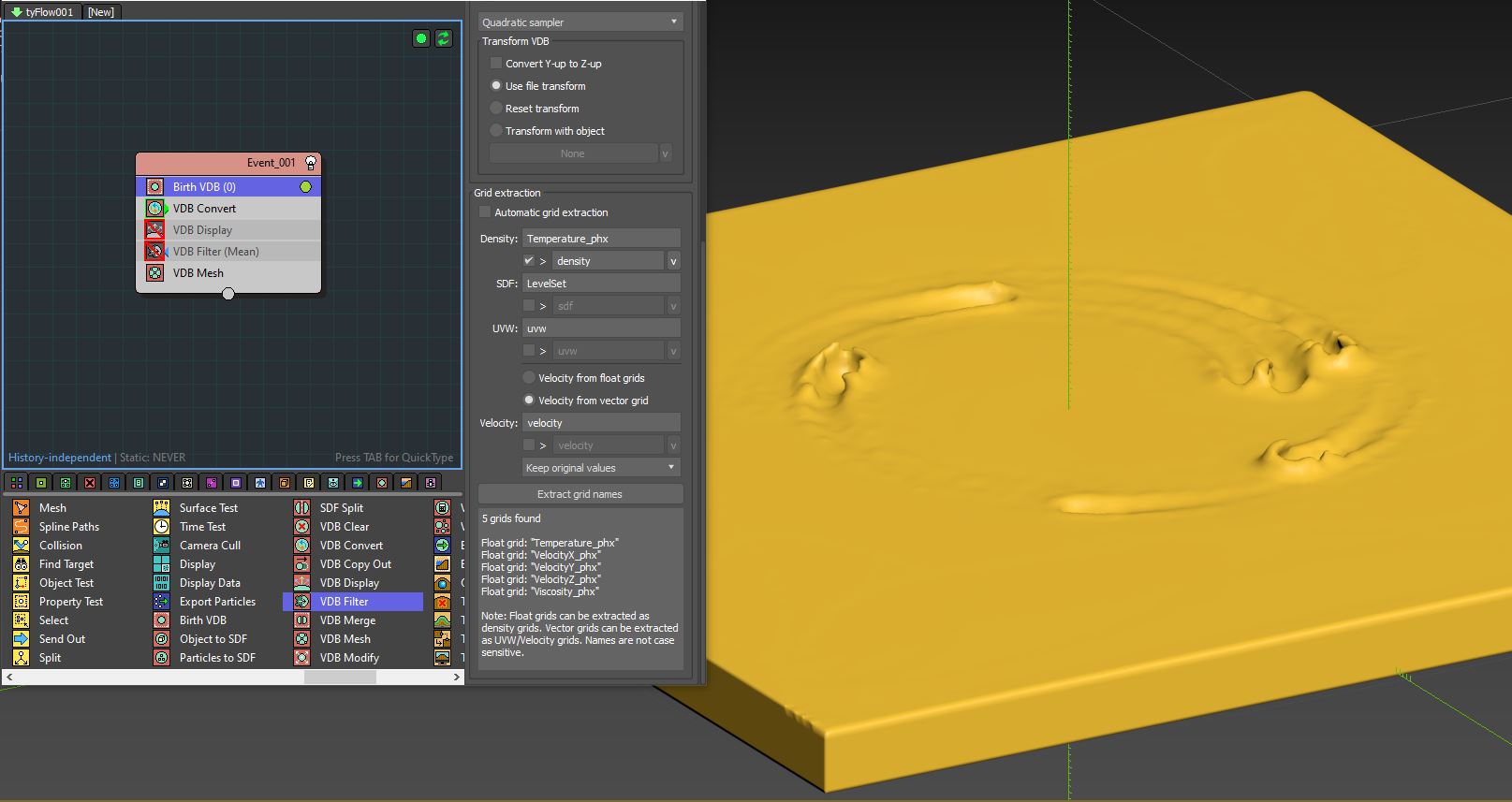

I have an other issue from a Phoenix FD simulation :
When I load a VDB sequence and I add a filter I get some bugs... please see attached files and a few frames from the sequence.
https://filevert.fr/d/2t_5B_s_5D_Cl93+XsWkGfL5cnU=
