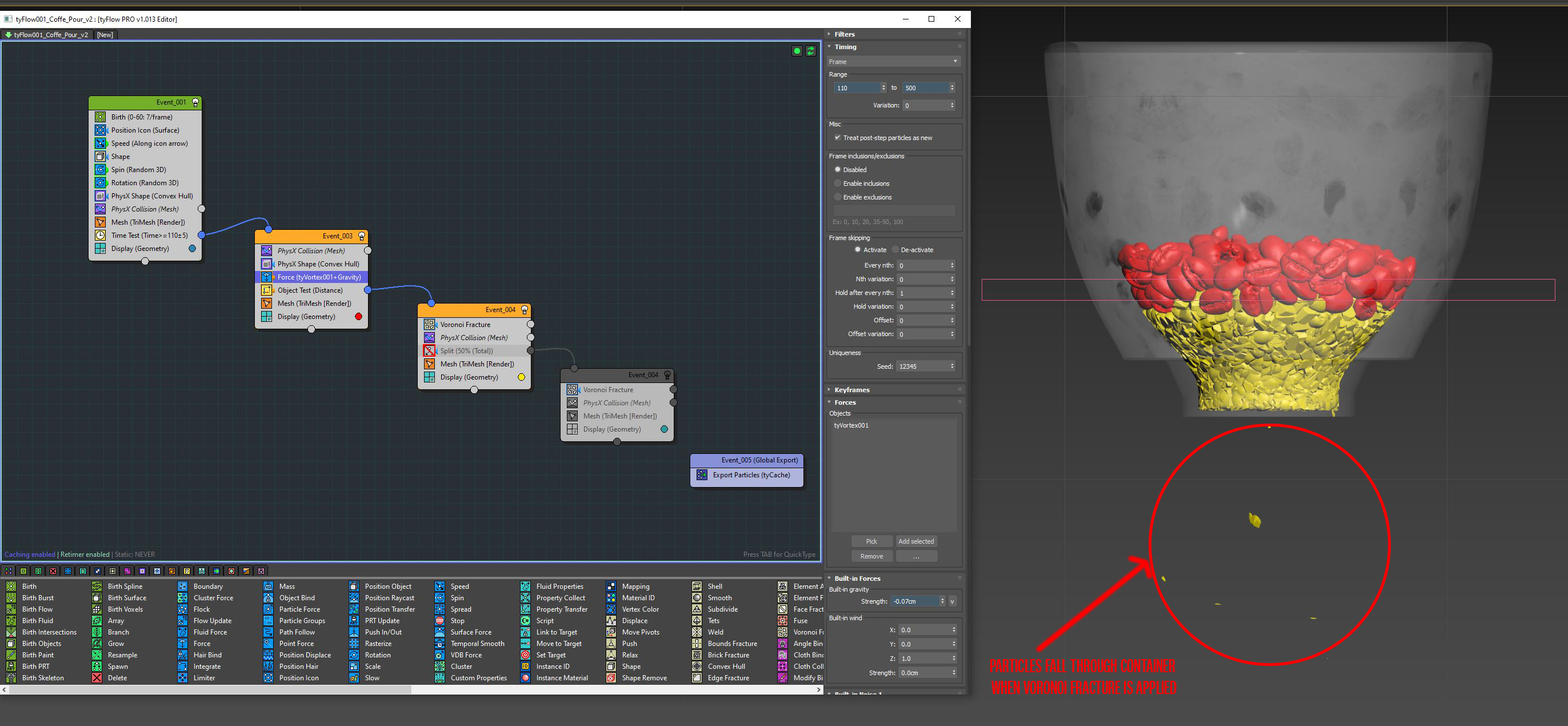

I'm trying to recreate an effect of coffee being grinded similar to the reference attached.
I'm using a force to spin the beans that are then broken up using a voronoi fracture, which is activated with a object test moving from bottom to top.
I'm having an issue that when the particles are broken with the voronoi fracture they start to leak through the container although it's closed. This is giving me problems at render time as the geometry won't load by the renderer (Corona Renderer) I'm using.

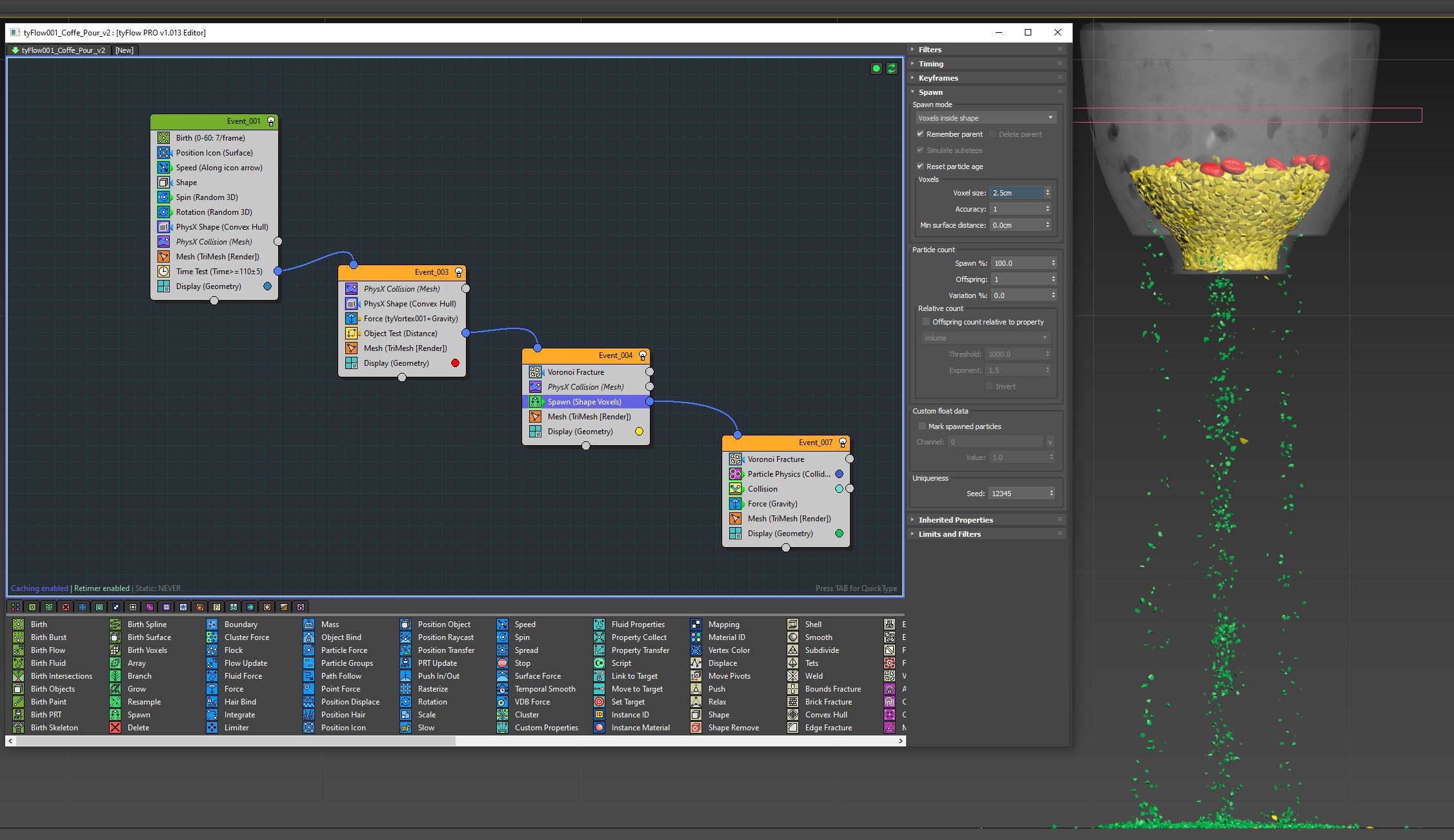

I've attached the adjusted flow below but I'm unsure if I understood the set up correctly. Also with the spawn operator I'm unsure how I delete the parent over time?
The leaking particles has improved a lot with your suggestions apart from the last event where I switched to collision as it's faster than Phyx collision. I actually previously tried the surface test method to delete the particles outside the volume but like you said it ended up deleting most of the particles in the volume.
