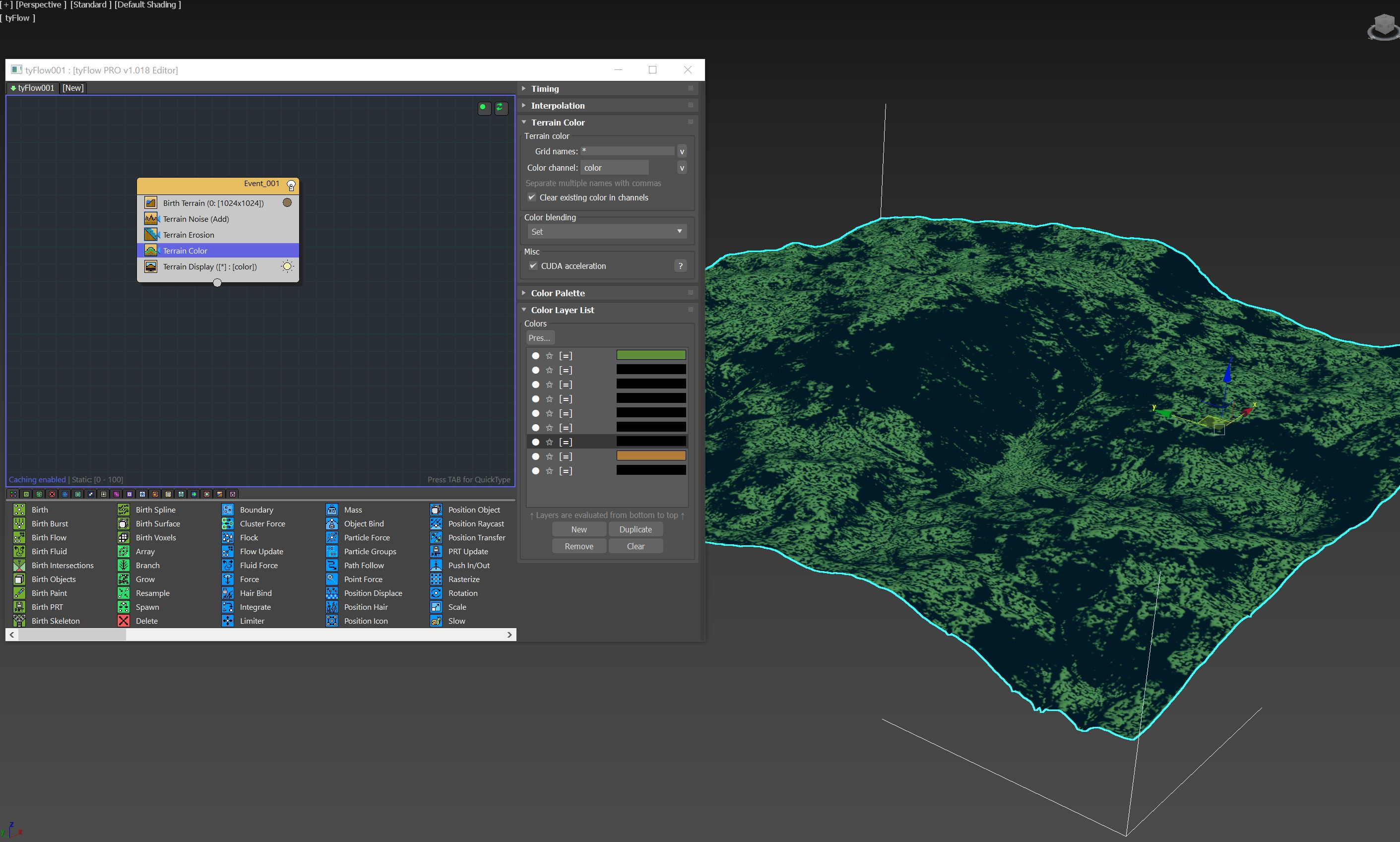

Hi. I noticed my terrain color presets does not work, most of them are just black, some is a color here and there but the rest black.
Ive also notices when I do different erosions, the different presets barely give a different result. I've tried on both 3dsmax 2022 and 2024, and I tried to reinstall the plugin. nothing works. please help
I've also noticed now that the terrain presets doesn't work either. it just creates a black flat plane.
PLEASE! can someone help me
with further testing now I can't seem to fix the problem. Adjusting the presets seems like it changes things.
some of the graphs are completely flat, and as soon as I adjust them I can see some terrain.
I've also tried to adjust to different unit setups. but nothing helps. I'm out of ideas.
I have a deadline next week so really hope someone can help me with this.
