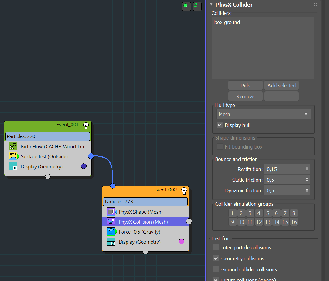

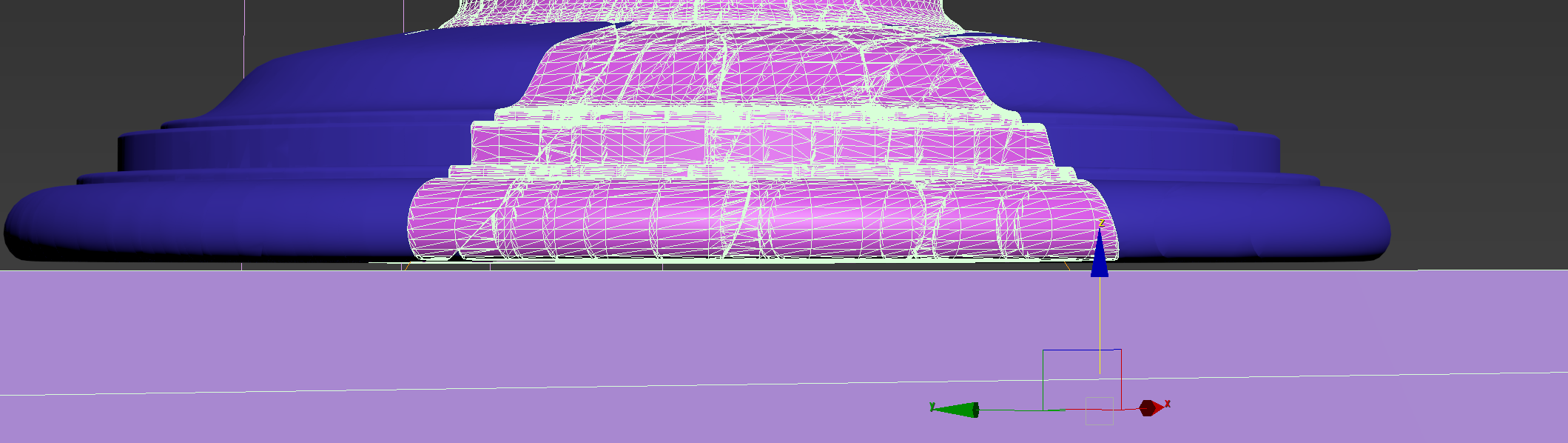

actually a very simple scene, but I am struggling to let the object just sit on the box.
Even with 1/8 and a gravity of only -0,5.
What's the reason? Scene is attached...

Thanks, your object is falling through because you've set its PhysX Shape collider to Mesh mode. As it says right under the dropdown, Mesh mode is not supported for dynamic particles.
(09-12-2023, 06:16 PM)tyFlow Wrote: Thanks, your object is falling through because you've set its PhysX Shape collider to Mesh mode. As it says right under the dropdown, Mesh mode is not supported for dynamic particles.
Okay thanks! I didn't notice that. This explains a lot trouble I had Wink
