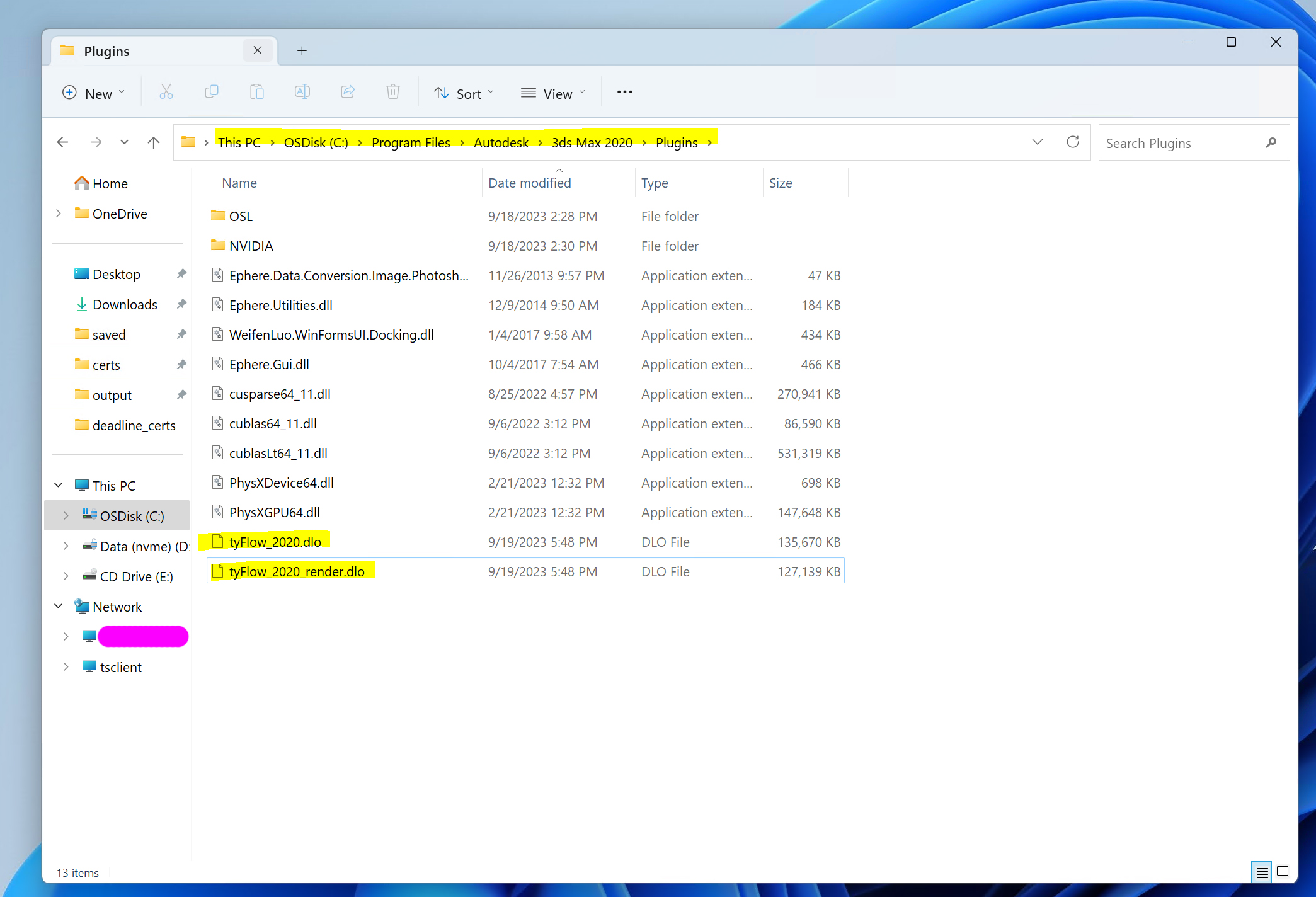

I have installed TyFlow Render and TyFlow (Free) on our worker nodes (see attached).

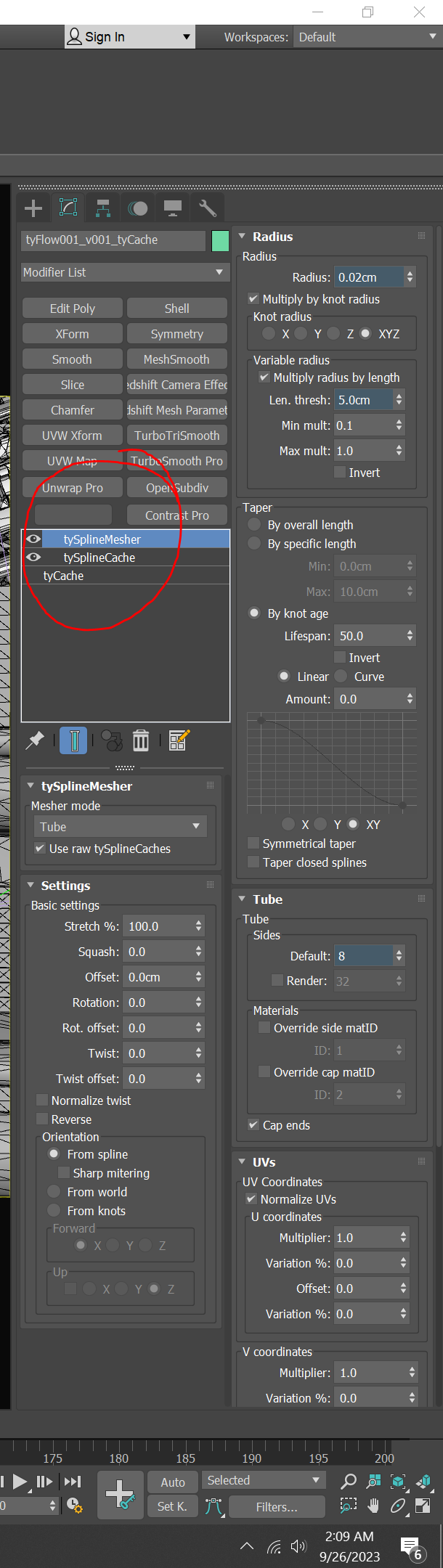

Here is the modifier stack for a TyCache that was exported from our workstation running TyFlow Pro (see attached).

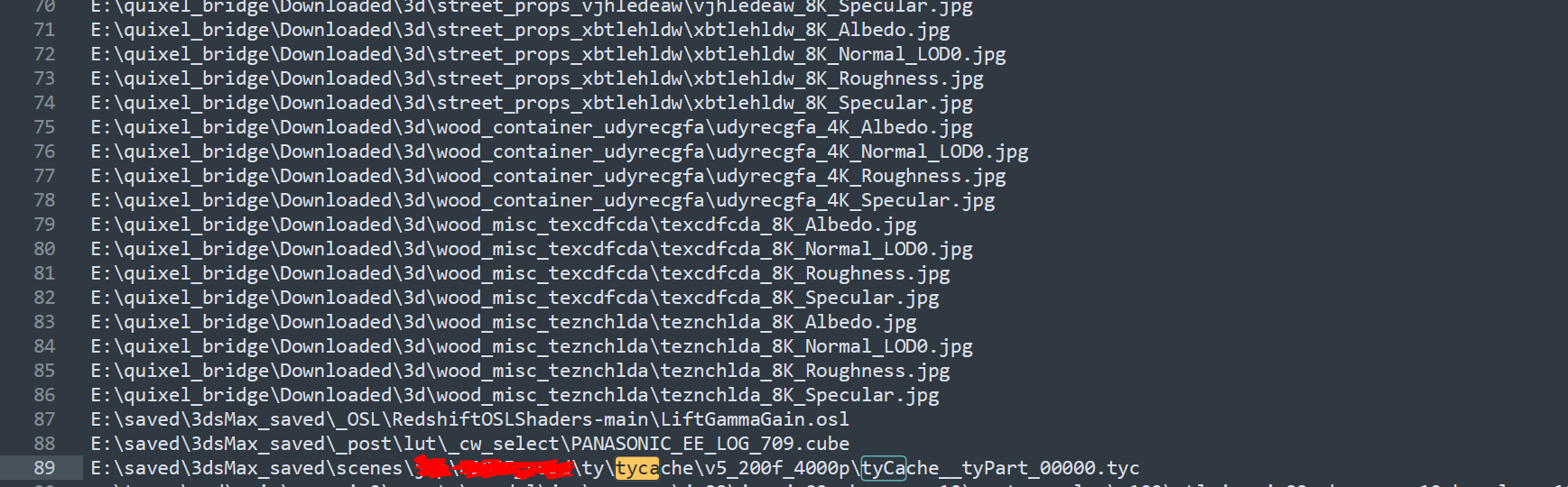

How can I verify that Deadline is submitting the entire tycache - is Deadline not able to send the entire tycache (see attached)?
Do we need to manually copy the TyCache to a new location for Deadline to render an image sequence with TyCache?
